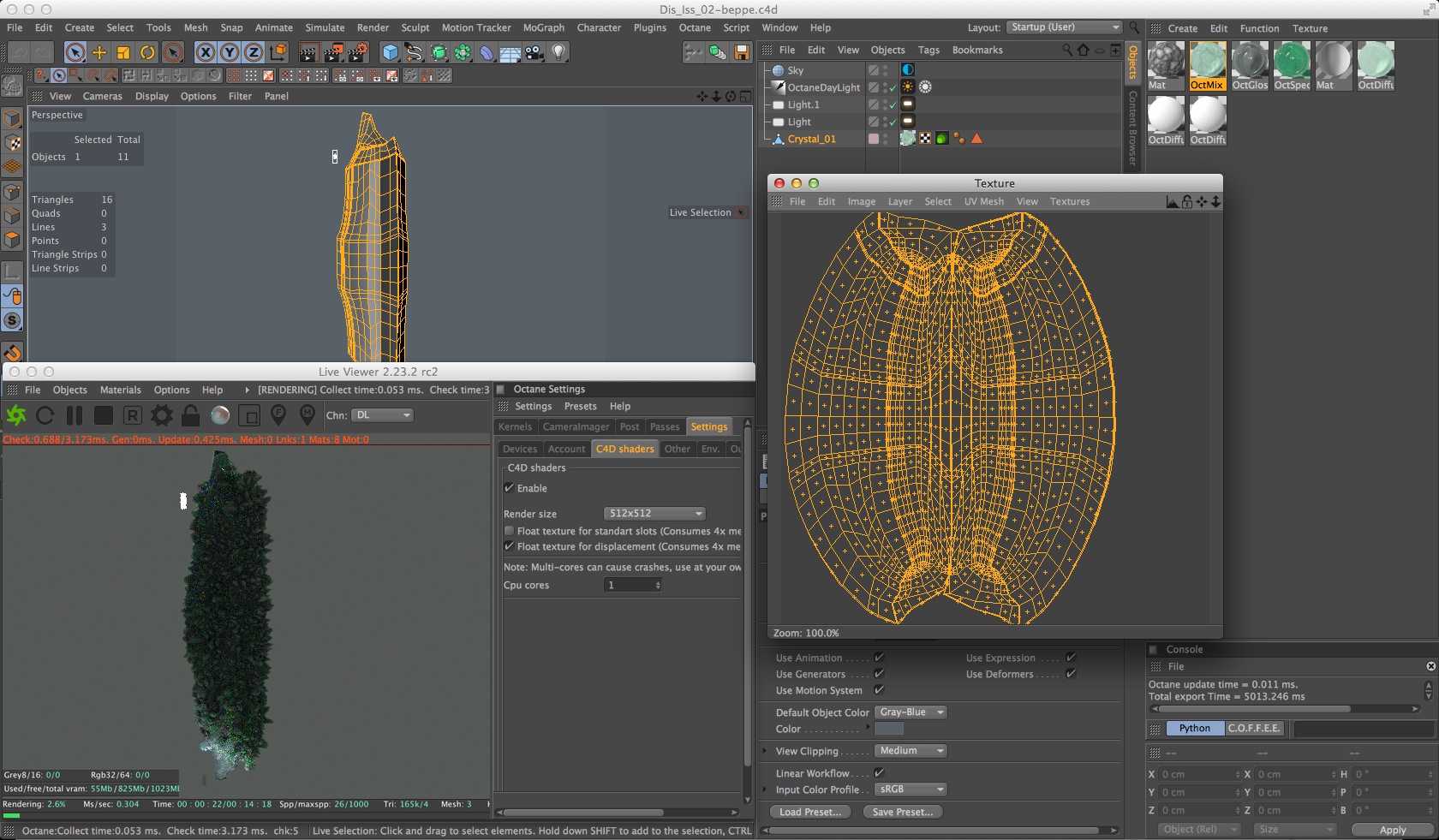

Posts: 10598
hi bleepurchin,
I have modified the uv of your second model without changing the polygons subdivision:
Dis_Iss_02-beppe.c4d.zip
(177.35 KiB) Downloaded 113 times
As Yambo said, the uv unwrapping is crucial for good displacement ;)
ciao beppe

Yeah thats how I unwrapped it in the end... you cant seem to get away from the seems being at risk of weird results though...
