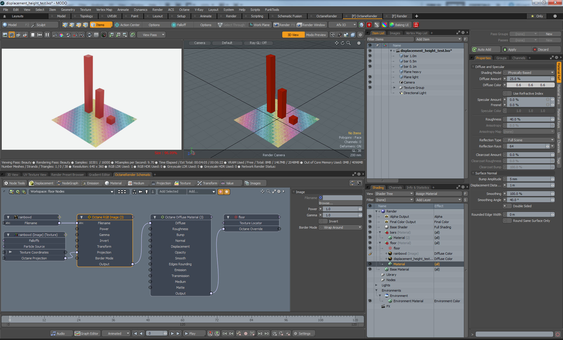

Paul, as you know, I've been experimenting with my own layout (and you've added a couple of my suggestions into your own layout)
I started with modo 901s render layout and tweaked from there. The way I work in the render layout is very similar to the work I need to do in octane.
The main changes I have made in my own layout are:
1. Added an extra camera (3d view) to the right of the octane viewport (with some scripting to switch the 3d view to a modo preview)
2. Added a redesigned octane toolbar to the top, with some scripting for stuff I want quick access to, which normally require more clicks (eg. preferences, changing render passes, changing render priority, clay mode etc)
3. Added render stats to the middle (with some scripting to toggle on/off)
4. Added redesigned node/materials toolbar into the bottom schematic (groups node tools into a single popup since I use this less)
5. Added the octane node properties into the right of the schematic (not totally happy with this, but there are problems with adding this stuff into modo's properties on the far right)
6. Kernel/camera/env/passes forms are in popovers split into subtabs (you ended up doing something similar in your latest layouts)
7. I also put the Kernel/camera/env/passes forms into the right column properties where the other modo render properties are (although I tend not to use it much, opting to use the buttons/popovers instead)
I'm not completely happy with it and continue to tweak things all the time, but in general, it's working pretty well for *me*.

I do like having a basic Octane layout that can be customize easily. Funk's customize layouts looks similar to the Modo render layout. Adding separate shader list next to schematic editor is quite useful and is something I have done already.
