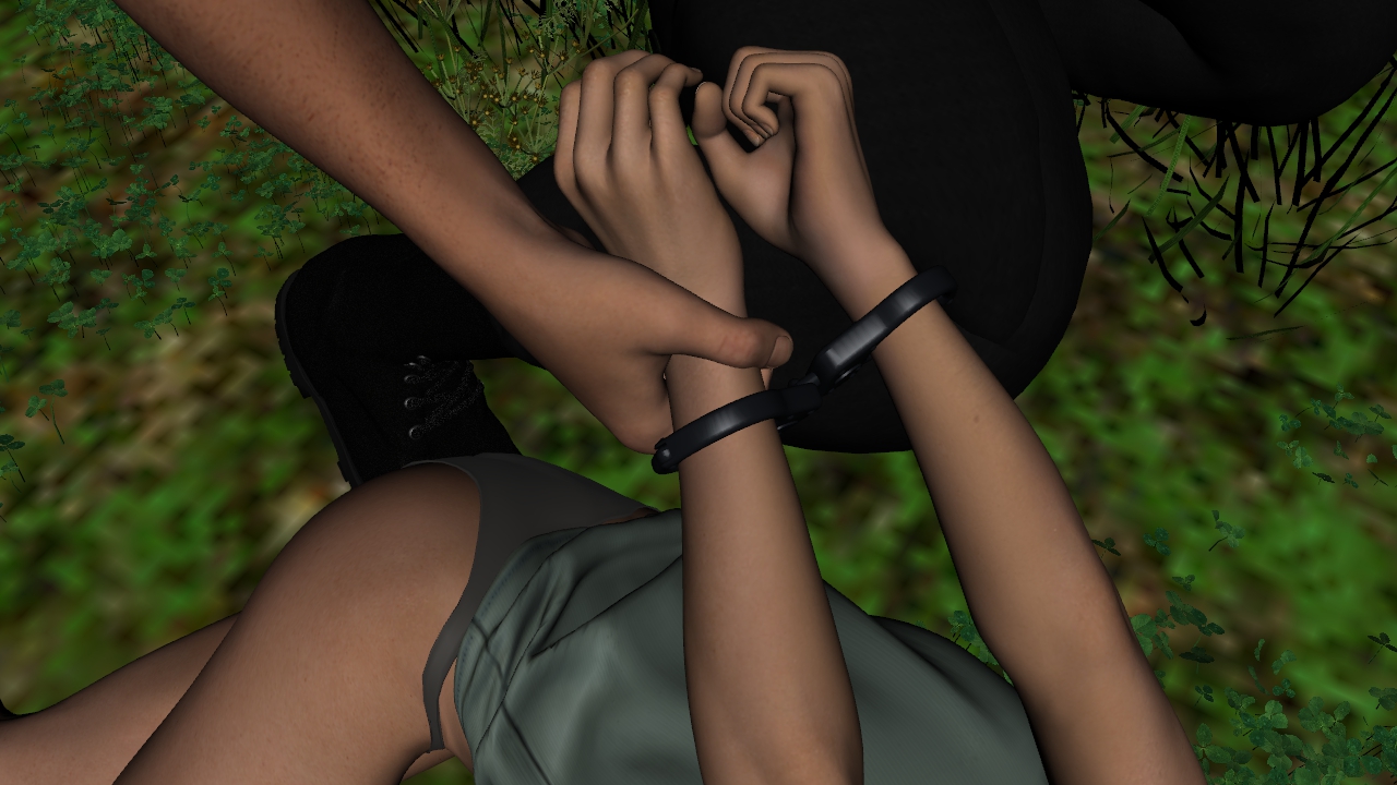

Ok, I have tested it a bit, so my first impressions:
  • Inputs work now completely different from Studio - must press Enter after typing anything into input boxes to actually change the value, plus keyboard input conflicts with Studio's Keyboard navigation (Shift-K helps, or uncheck the 'keyboard in circle' button on the Studio toolbar) - sometimes focus gets stolen by Studio especially when you press one of WSAD buttons.
  • Doesn't pick up environment when loading old .duf, materials seems OK but this needs more tests, especially when materials use graphs. Environments saved as presets in prev version do not work either, so just set default daylight without any tweaking.
  • Nasty habit of freesing when loading scene, when building geometry, when preparing for final rendering. Cool devs spit on multithreading, don't they?
  • Even more nasty habit of hiding the viewport window while render is in progress. Render doesn't stop just viewport becomes invisible. Hitting 'Open viewport' may or may not restore it, sometimes it gets restored by just clicking anywhere on Studio window (or that's because render has finished?)
  • Do my eyes betray me or we're seeing something very familiar in the following animation frame?
OctaneRender viewport
Ain't girls hands pure white? Poke throughs because of smoothing modifier is not picked up? Base mesh instead of subdivided? (or I must always use Final for that, 'Use Base mesh' is unchecked in Preferences) Handcuffs misplaced? (sorry for harsh image, but I just loaded the shot that was 100% problematic for all prev versions)

asennov wrote:Ain't girls hands pure white?.
Are the geoshells on the character? Remember to hide all unnecessary geoshell surfaces, especially if you're just now adding geocrafts. Otherwise, did you try saving and reopening the file? Also keep a look out for missing textures from image nodes.

asennov wrote:Base mesh instead of subdivided?
Have you tried hitting reload at bottom of viewport? Also verify the mesh is high resolution and try changing the subdivision to see if it updates the scene correctly.
