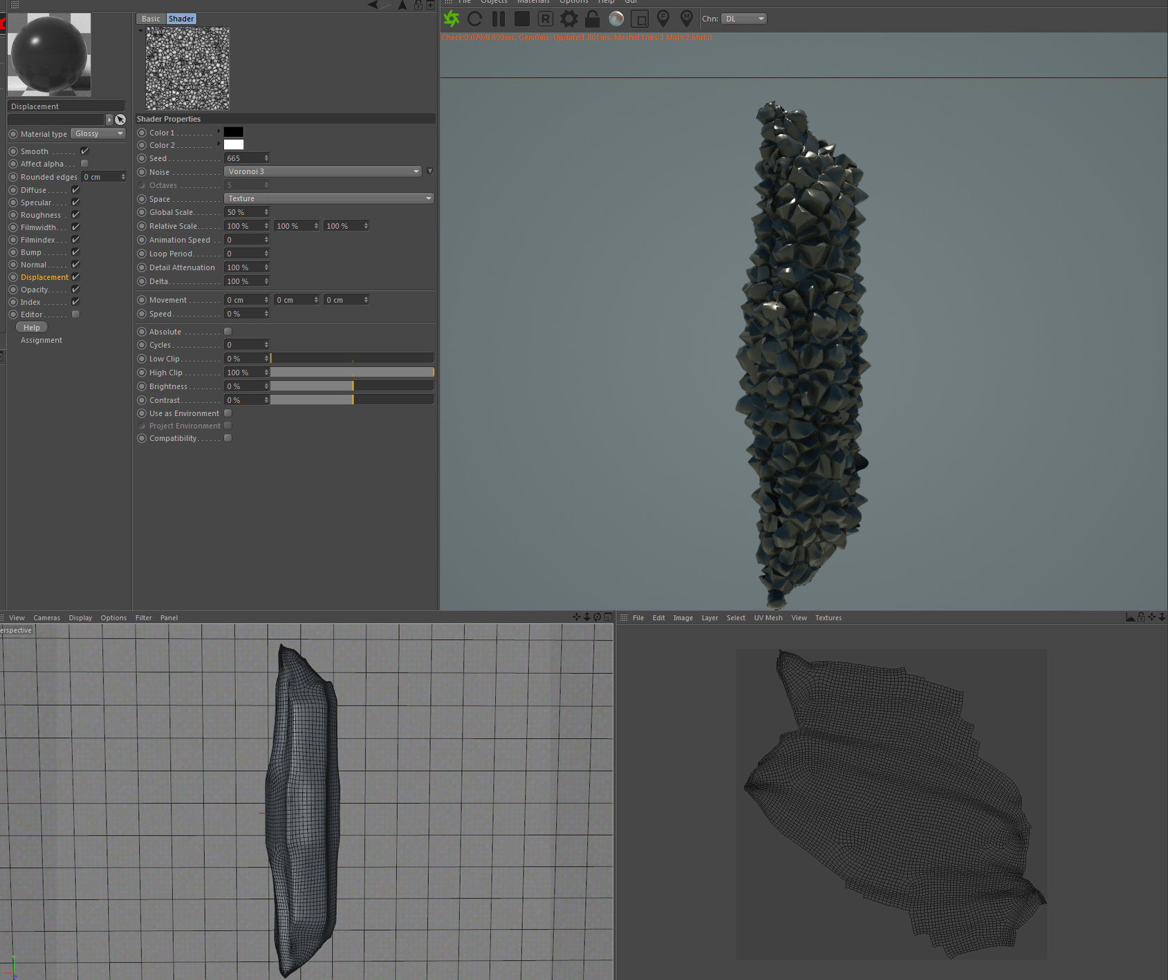

Please find attached screenshot from your scene file optimized correctly.
As you can see Displacement is working properly after i did some quick retopology & unwrapped the UV's.
Your topology was far from being something to work with, and your UV's where just a random thing. (also your scene scale was huuuuge)
Displacement is working just fine when you know your limitations.
If you ask me? Start by learning unwrapping UV's

Ok so I've remodeled it and here it is. I've not made the mesh as dense as yrs as I figured I could use the object tag to smooth the mesh for me.
Am I right in thinking that I can unwrap this mesh now? I'd like a word or advise on that before I take it much further please.
