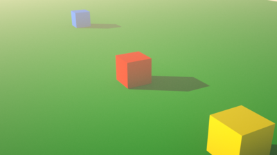

Here is a quick blend file for you to look at, I'm using Roubals method here.
fog-test.blend
(582.12 KiB) Downloaded 165 times
Make sure to recalculate the inside normals on the sphere around the camera, otherwise it will not work. Hope this helps.
Jason
Linux Mint 21.3 x64 | Nvidia GTX 980 4GB (displays) RTX 2070 8GB| Intel I7 5820K 3.8 Ghz | 32Gb Memory | Nvidia Driver 535.171
voon
Posts: 527
Joined: Tue Dec 17, 2013 6:37 pm

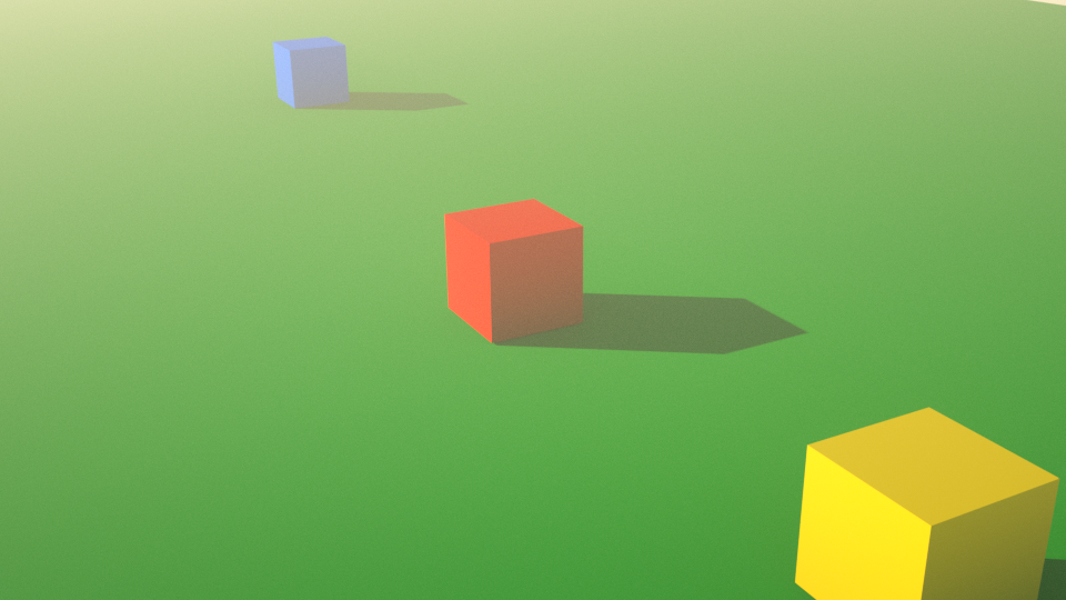

Thanks a lot for the file! I found my problem .... scale. My spaceship is over a kilometer long and the camera pretty far away from it to get it onto the picture. I had to tune down the scatter value to an impossibly small number to get to a point, where it wasn't just all scatterlight..... I currently use 0.00002 .. I can't seem to go lower, or octane server errors. But: it's still way to bright then and I can't see the sky texture at all.
Is this scatter medium trick only usable for small scenes? I'd need an idea of how to add a little haze with real depth to scenes, that stretch for kilometers (huge landscape shots, entire planets etc).
grimm
Posts: 1332
Joined: Wed Jan 27, 2010 8:11 pm
Location: Spokane, Washington, USA
I had the same problem, the picture above was rendered with Direct Light (ambient occlusion). PMC and PT appear to be broken and don't work very well. I was able to get PMC to work ok but there was no shadow attenuation so it didn't look very good. :( I think we are going to have to wait for 3.0 to get a good fog.
Here is how it used to look with PMC on an older version of Octane (I can't remember which version). It doesn't look as good as this now.
