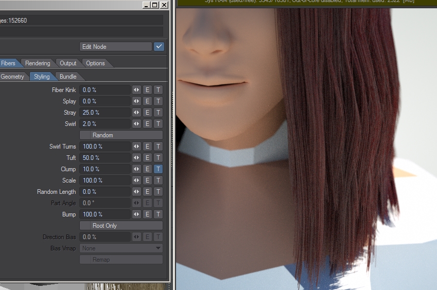

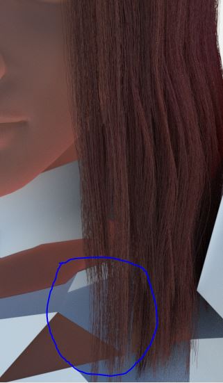

hi everybody!
I tried fewdays for this problem
Changing filter size value several time but it's not help for me.
I know octane has no antialiasing filter.
But i think this probelm from antialias.
Anyone has same problem with FiberFX hair and have good solution?
hair noise of aliasing

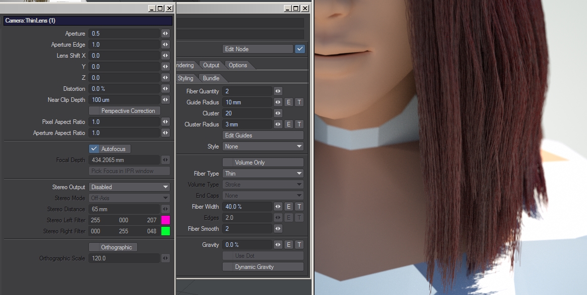

I think that the main problem is that the hair is too thin. With a 40% fiber width the render works better. Also a bit of DOF effect could help with hair rendering.
-Juanjo

But I think that the big problem in this scene is the "Fiber Kick" effect that you have at 10% ... it introduces a high frequency pattern in the hair geometry that seems an aliasing problem.
-Juanjo
