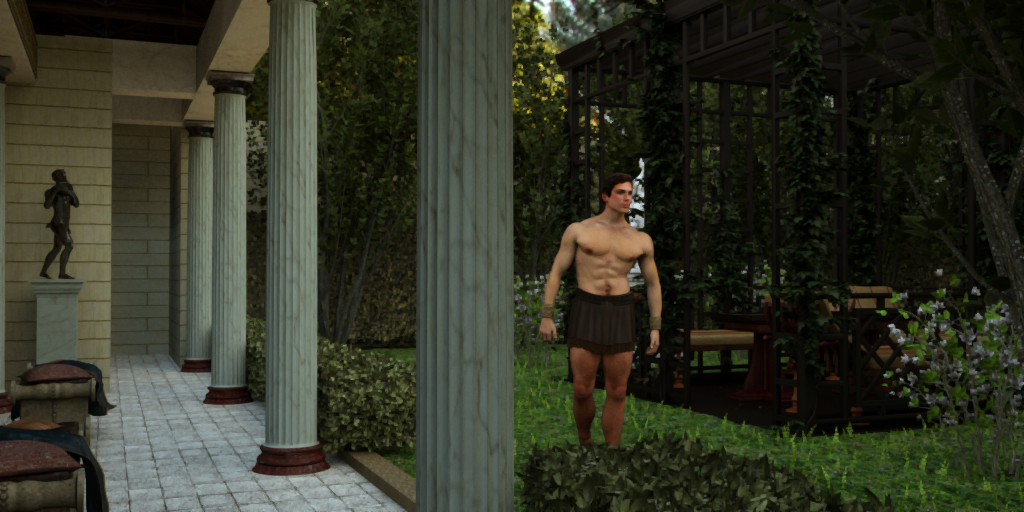

Umm, I just restarted Poser Pro 2014 and opened a version of the file in question where there are even more transparency maps and got a successful render. Oh and just prior I downloaded and installed the beta of the Poser plugin. I'm confused alright :)
just 1000 samples but that's all I ever required
