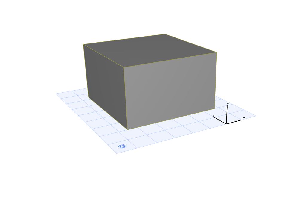

As you can see i have a simple cuboid in archicad. created in a complete new archicad file with nothing else in it.

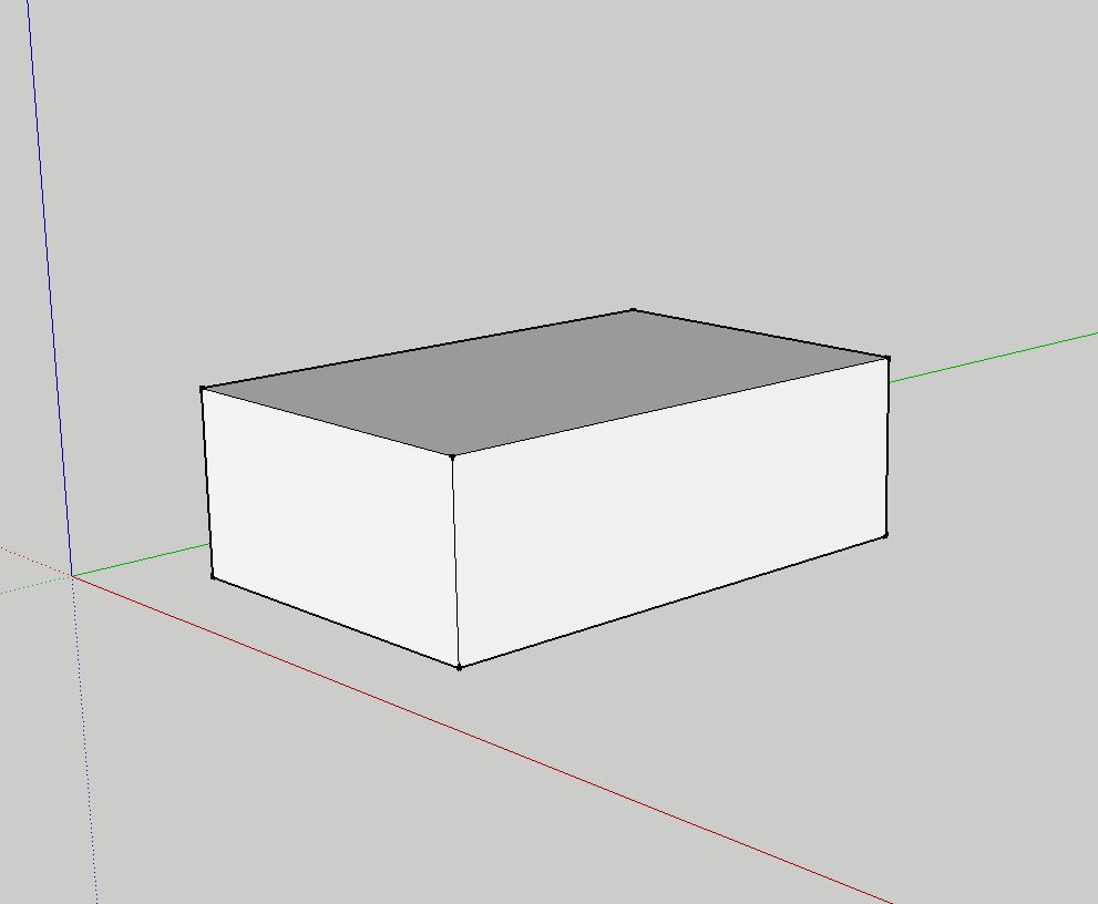

I create a cubiod in sketchup
Attachment 4:
Export cubiod as .obj file

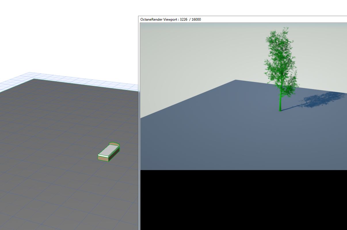

I have to chairs, working as proxys
obj from sketchup is working as itended
obj from archicad not

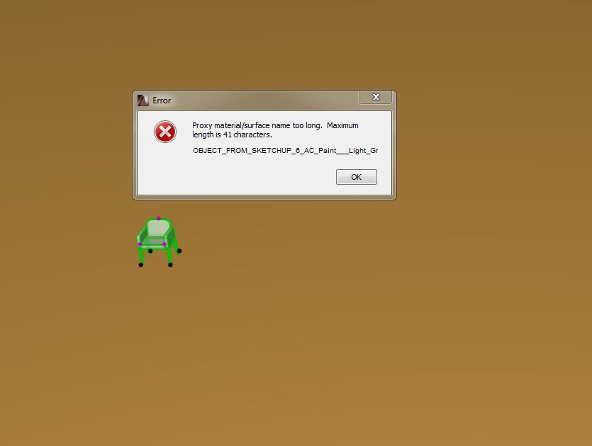

attachement 6:
here is the error that ocurs normaly. the surface that is stated here does not exist. not in the mtl file or in the archicad. i dont know from where this surface could possible come from. furthermore did i check the .mtl file:

The "material name too long" error comes from using a plugin release that is a little old. Update to the latest TEST build to fix this.

upgrading the plugin did the trick :)
the trees are now in!

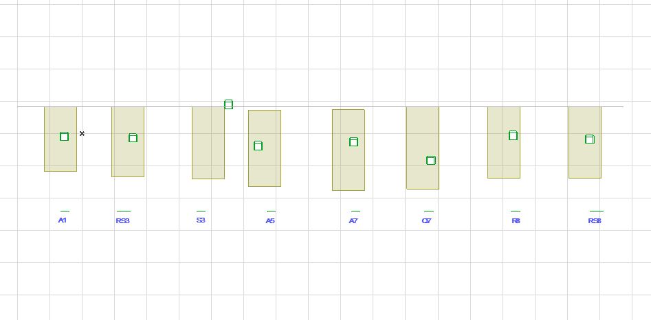

1: my proxys from one archicad file
attachement 1
attachement 1
2: proxys seen in the octane viewport. car in the middle is a audi a7
i saved the materials as default
3. i copy the chair that represents the audi a7 to the clippboard
4. i paste the chair into a new archicad file
5. no succses. audi is red from the standard proxy file and not the gray it should be.

Your workflow is correct.
When you "copy" a proxy into the clipboard, you are really copying the ArchiCAD host object, which contains a tag indicating the OBJ filename of the proxy object - but it does NOT copy the materials for that proxy. So the step of "Save Current Proxy Materials as Defaults" is needed so when the OBJ is loaded in the next scene, it picks up the new defaults. However..the "Save Current Proxy Materials as Defaults" function is not working correctly (and potentially has never worked!). So this workflow is failing. I will try to get a fix for this in the next release.
In the meantime, you could use an ORBX file instead of an OBJ file, which allows you to specify the materials in the ORBX file.
