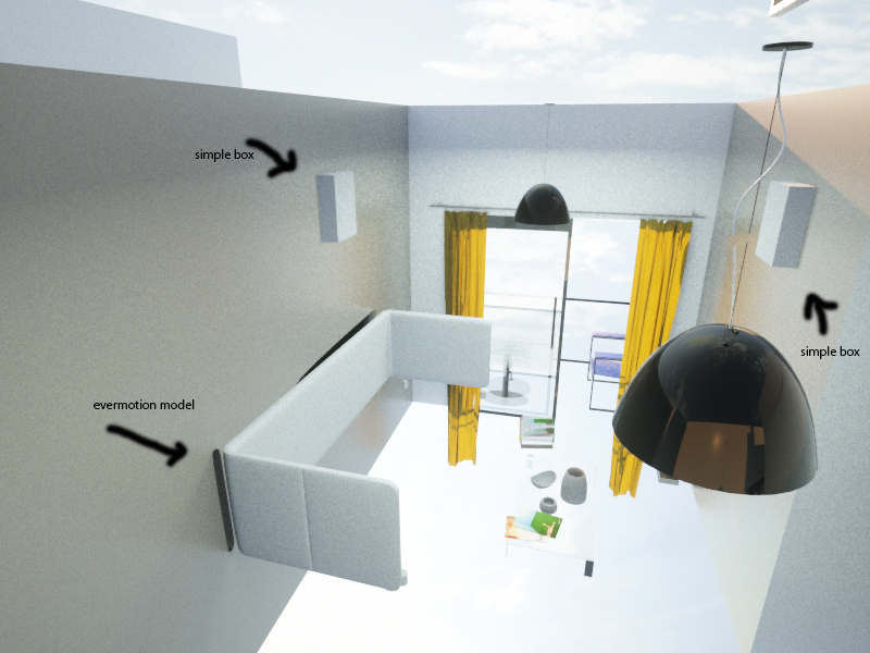

the unique way i find to avoid this error was scalling all scene 4x
some one can help ?
Ambient occlusion error with evermotion models

You can try to decrease the AO distance in the direct lighting kernel.athosrojas wrote:the unique way i find to avoid this error was scalling all scene 4x
some one can help ?
cheers,
Thomas
