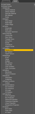

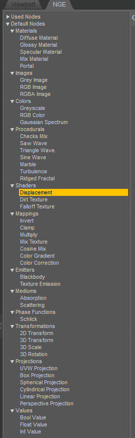

It's under shaders when you add a node. It always takes me a few to find it.dpliu wrote:Thank you for your reply. However, my problem is, I don't know how to add a displacement map. Not like in Octane stand alone version, there is a "displacement" in the materials. But in DAz plugin (at least mine) no such thing in any of the materials (there are diffuse, specular, bump, opacity though, just no displacement). How did you add that? Sorry if it's a stupid question. I'm new to this plugin.
I presume you are using a version older than 2.x, which did not support displacement, or you need to reinstall from the first post in the first stickied thread of the Daz Studio plugin subforum (says 2.15 prerelease in caps, can't miss it).
