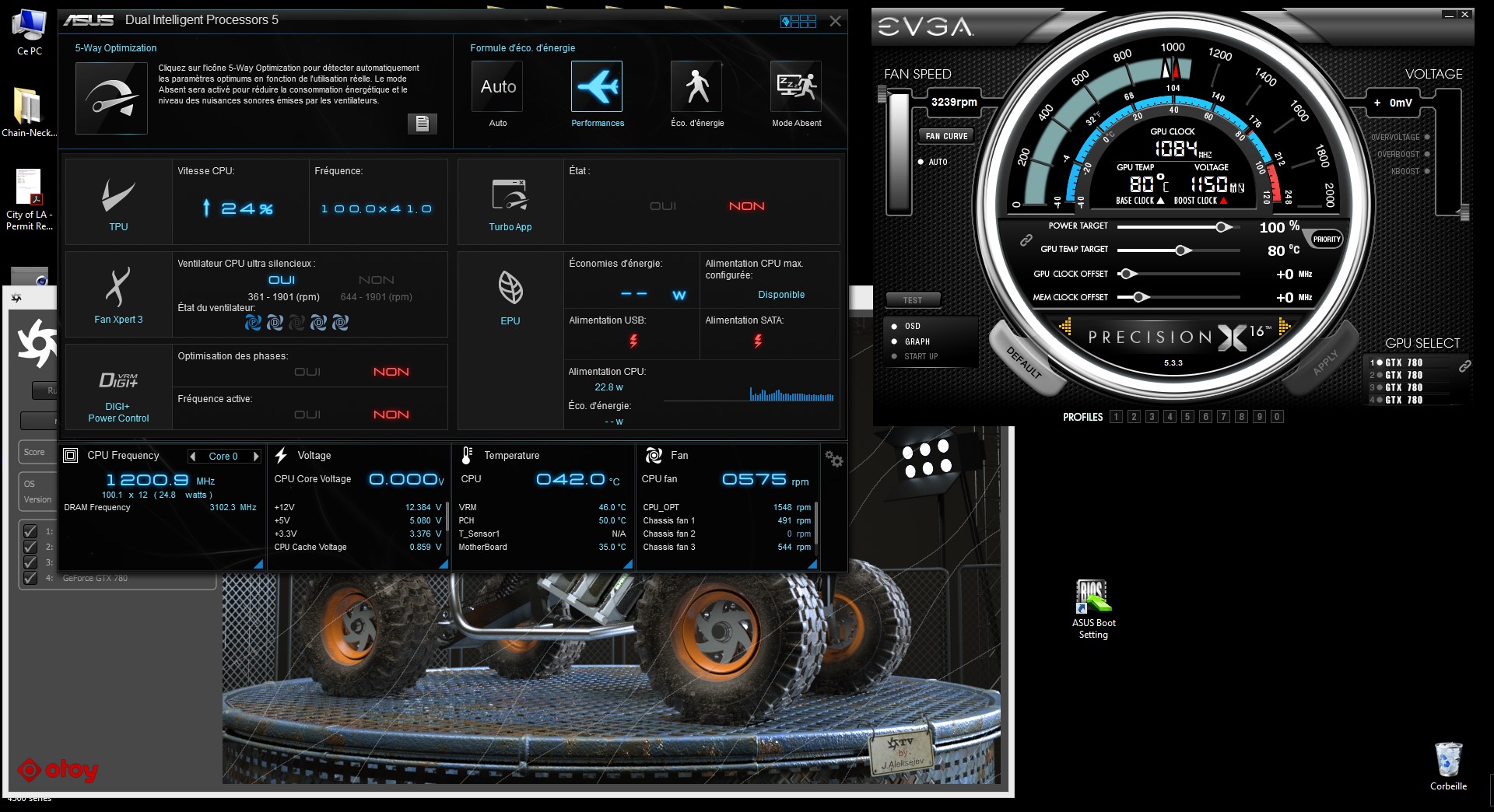

@Smisha :
So, I ran the benchmark (https://render.otoy.com/octanebench/), here is the result :
Also Did a bunch a screenshot during the benchmark to monitor the heat / speed / etc.
Let me know what you think.
Thanks.

smicha
Posts: 3151
Location: Warsaw, Poland
So far so good.
Moments when boxes arrive are always exciting. Collect all parts and take your time. Don't rush. It's lots of fun. There is nothing to be scared of.
Your result on water will be 20% faster, cooler and quieter.
