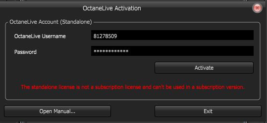

all of a sudden im getting this message The Plug-in License is not a subscription license? but i haven't got a Subscription license.
i installed Octane Vr ... then installed and this is what i get ? just want to use Octane again but now my license doesn't work?
HELP PLEASE
Natty
License error?
It looks like you have installed OctaneVR and activated an OctaneVR Subscription license, which conflicted with an existing OctaneRender license.
The OctaneVR subscription license is incompatible with plugin licenses, which has resulted in this error.
To fix the error you are experiencing, open OctaneRender Standalone (Not OctaneVR) and activate your OctaneRender license.
