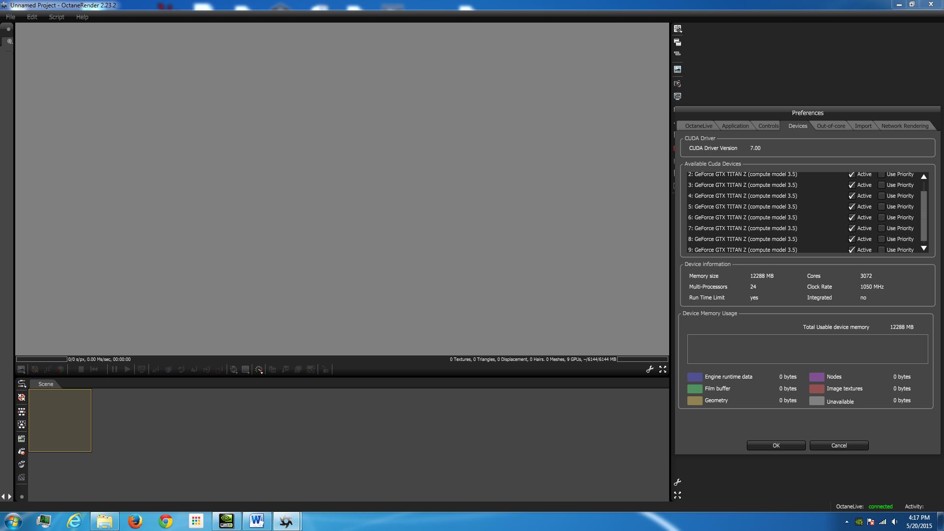

Now a serious question: you have 4xZ+1X which work in octane. What do you think, guys, if this IO space for such config is seen same as 5 gpus or 9 gpus?
Notiusweb,
Is there any chance you could connect more cards (borrow them for test purposes) to your system to exceed the 10 gpu windows limit and see if all of them work under octane?

B) 10 GPU - I have successfully tested adding another older card, GTX 660 Ti. It works fine!
I actually wanted to try 11 GPU, as I have another PNY Titan Z, which has an issue with one core, but my PC could not boot up with 11 GPUs going. I got "BF" error code on motherboard at pre-BIOS whenever more than 10 cores. I actually had to remove my CMOS battery to get motherboard working again. Don't know if this is what is causing the pre-BIOS "BF". It is scary, the PC just tries to reboot itself over and over. Maybe 64GB of ram would fix, I don't know...So, I think hardware-wise, for some reason 10 GPU cores will be my system's max? I never even could get to BIOS in repeated attempts when I tried more than 10 cores...
But, same riser, same cables, GTX 660 Ti (1 core) worked. And I could get the PNY Z working if I disconnected another Z, so it is definitely feels like it is a limit of the motherboard.
Too bad the 660 Ti has only 3GB Ram...bummer...I am now thinking of a 780 with 6GB, or another X with 12 GB and 3,072 cores...but I may as well wait for the next mega single-GPU card with 12GB and 6,144 CUDA. This is all me assuming that 10 cores was the limit, of course. (The mobo has 7 PCIE lanes, it just so happens I am using dual core Z).
Anyway, fun stuff...

I am still curious if there is any way to get 12 gpus (octane limit) working on a single mobo (amfeltec splitters, any splitters, raisers,....)
