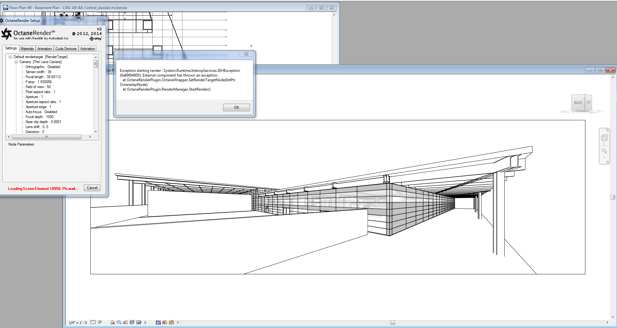

I can't get our model to consistently load as I keep getting the attached error.
I've tried with different view over rides.
Also happens when I try to reload geometry with a view open.
If I close Octane and then re-open it will lock the computer when I try to open view port again. So I have to close down Revit.
I've removed all instances of external geometry and unloaded Revit links. But keeps happening. Not sure what to do.

That error is indicating that Octane failed to start rendering the rendertarget the plugin provided. Suspect areas are running out of VRAM, or too many triangles.
If you go into the plugin Devices tab and click the Octane Log button, are there any errors?

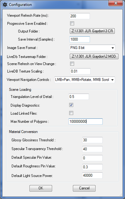

What is the Configuration Max Number of Polygons set to?

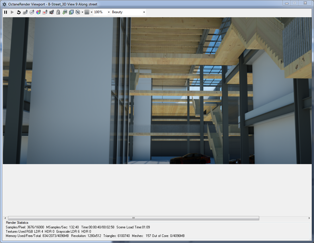

settings stats attached
Generally never more than 8-9m polys per view depending on how diligent I've been with applying view templates. Plenty of vram left over..
