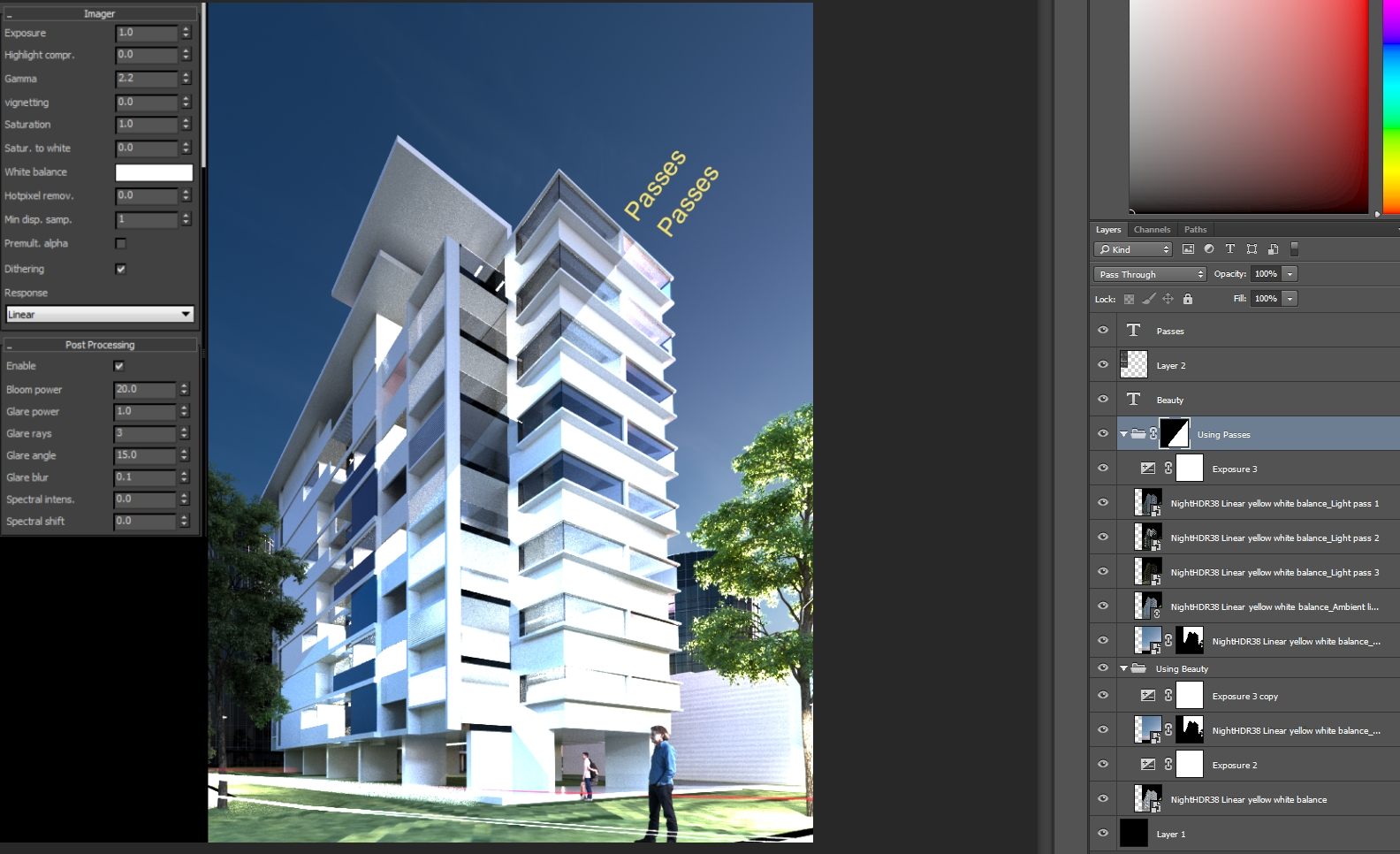

Im testing Render passes, and particularly Light ID passes, and trying to comp them to match the Beauty pass. I am unable to make them look the same.
Settings - Octane v2.23.2 - 1.8
Output HDR unclamped
Linear out, no white balance, no vignette, exposure 1. Other setting are in image.
(also sorry for the horrid render everyone, im just using a simple scene with no tonemapping to test).
Passes Used - Ambient + Light passes
Photoshop passes overlaid

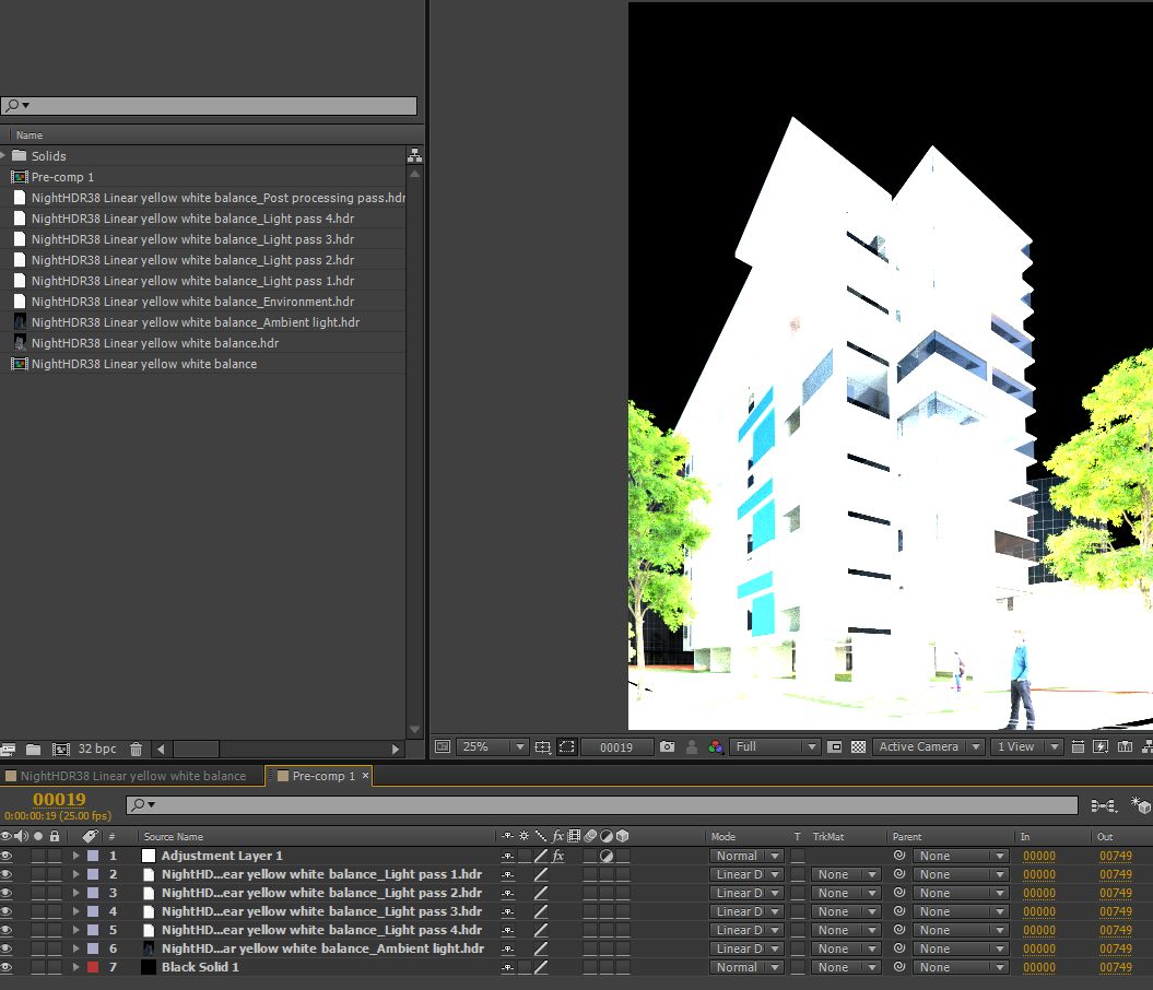

In after effects (image attached) the problem was worse.
I used Linear Dodge (Add) in a 32bit project.
After Effects
After Effects

Don't use srgb images on saving. Result would be great If everything is linear.

I was able to get it to work in Photoshop now by setting gamma to 1.
Things that produce incorrect Output -
- response must be linear
- any gamma other than 1
Post process pass works fine.
Could not get it working in after effects (using a 32 bit project color setting with Linear dodge) though it was very close after I also selected the Color settings/blend colors using 1.0 gamma. Is there another setting im missing.
