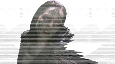

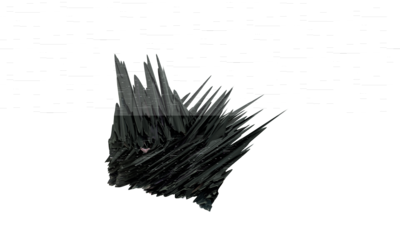

lately i get strange "watermarks" when rendering stuff with image sequences in its materials.
So always the first frame gets weird artefacts like known by gpu issues.
I attached two images to show what it looks like.
You can see my specs in my signature, any suggestions what could be the problem?
I think 2 days ago it worked just fine, didn't update any drivers since then.
thank you and have a nice day!

version?
skoeth
Posts: 67
Joined: Sat Sep 27, 2014 12:48 pm
aoktar wrote:version?
2.23.1, both standalone and plugin.
MacPro5,1 OS X 10.10.3 | GTX TITAN Black, GTX 970, 3x GTX 780Ti, GTX 780
Posts: 16066
Location: Türkiye
Are you using netrender?
skoeth
Posts: 67
Yes, i'm using netrender indeed.
Anything wrong with it?
garytyler
Posts: 234
Joined: Mon Nov 10, 2014 7:40 am
Location: Portland, OR
This has happenedto me a couple of times using net render on the newest version. It only happens on the first couple of frames.
Win 8.1 / C4D R16 / Maya '16 / 5x GTX 980 Ti
abstrax
Posts: 5510
Some have reported this problem in the past, but I still don't know what the issue is, because I can't reproduce it here at all. What is the GPU configuration on your master and your slaves? Which OS are you using on the master and the slaves? Did you render HDR images or LDR?
Is there a way for me to somehow reproduce this issue? I really want to fix this problem, but don't have an idea where the bug is...
skoeth
Posts: 67
here comes my configuration:
master:
OSX 10.10.3 with a GTX 970 +external TitanZ and GTX 780
slave:
OSX 10.10.3 with a GTX 780ti + external 2x GTX 780ti
the externals are connected via the amfeltec gpu cluster - one for each machine.
running octane 2.23.1 both, standalone and plugin.
No HDR.
I think it happens when using image sequences, but i cant reproduce it as well, for today its just working without knowingly changing anything.
my first thought was image sequence + netrender.
