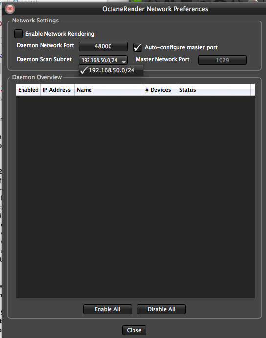

Yes, I went through that guide, but I can only get to the part where you select slaves. There are none. Running 2.23.2 standalone AND Cinema4D on both computers. Everything should be working. I still don't get an option to change the ip range. Though I changed the IPs of the computers to .10 and .11 so that shouldn't be the issue. No firewalls or port blocking. Wireless network. About the easiest path from one computer to another. Only a wireless router in between. No hardcore company lockdowns or anything. The computers are in the same room with the router. Only thing I haven't tried is wired at this point.

In your screenshot, network rendering is disabled. What happens if you enable it?
