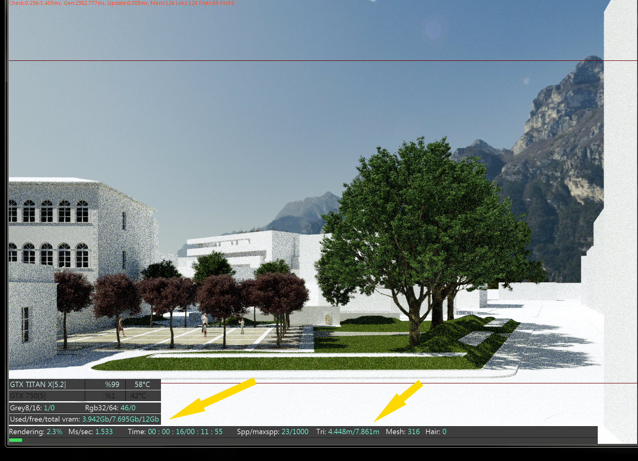

Thanks for your answer, I see on LV info:
I try to render in LV. Now I'm on 2.23.2 RC1, still same failure.
Very strange, I've about 200 objects in the scene and about 70 materials...

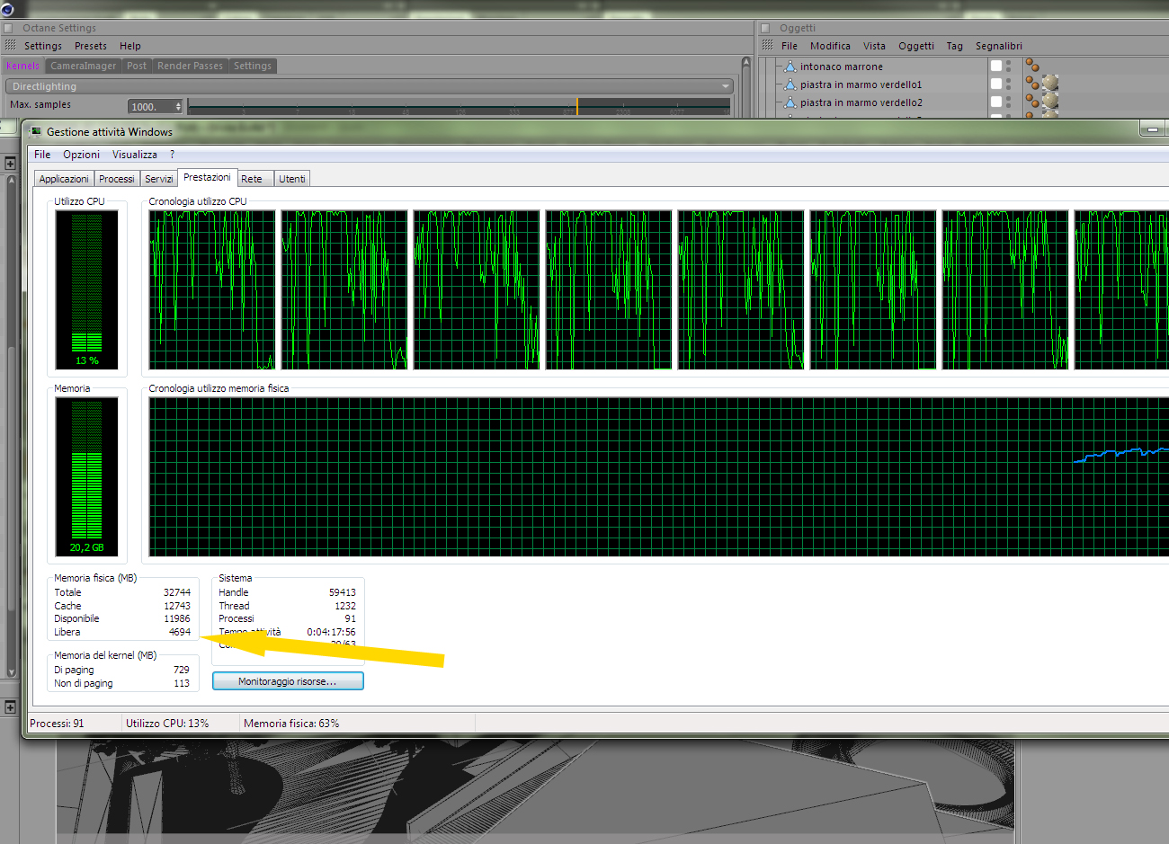

Ok I've found the problem:
as you can see in the picture I've a total of 32 Gb RAM on my system, but "cached" I've 12GB, so during the starting phase of rendering my RAM goes to zero and I've the "Render Failure error"
I think that some system RAM is shared with my video card, but I don't need that since I've 12Gb vram on board.
So,I ask you if someone coud teach me where I have to set this parameters on my system ?
