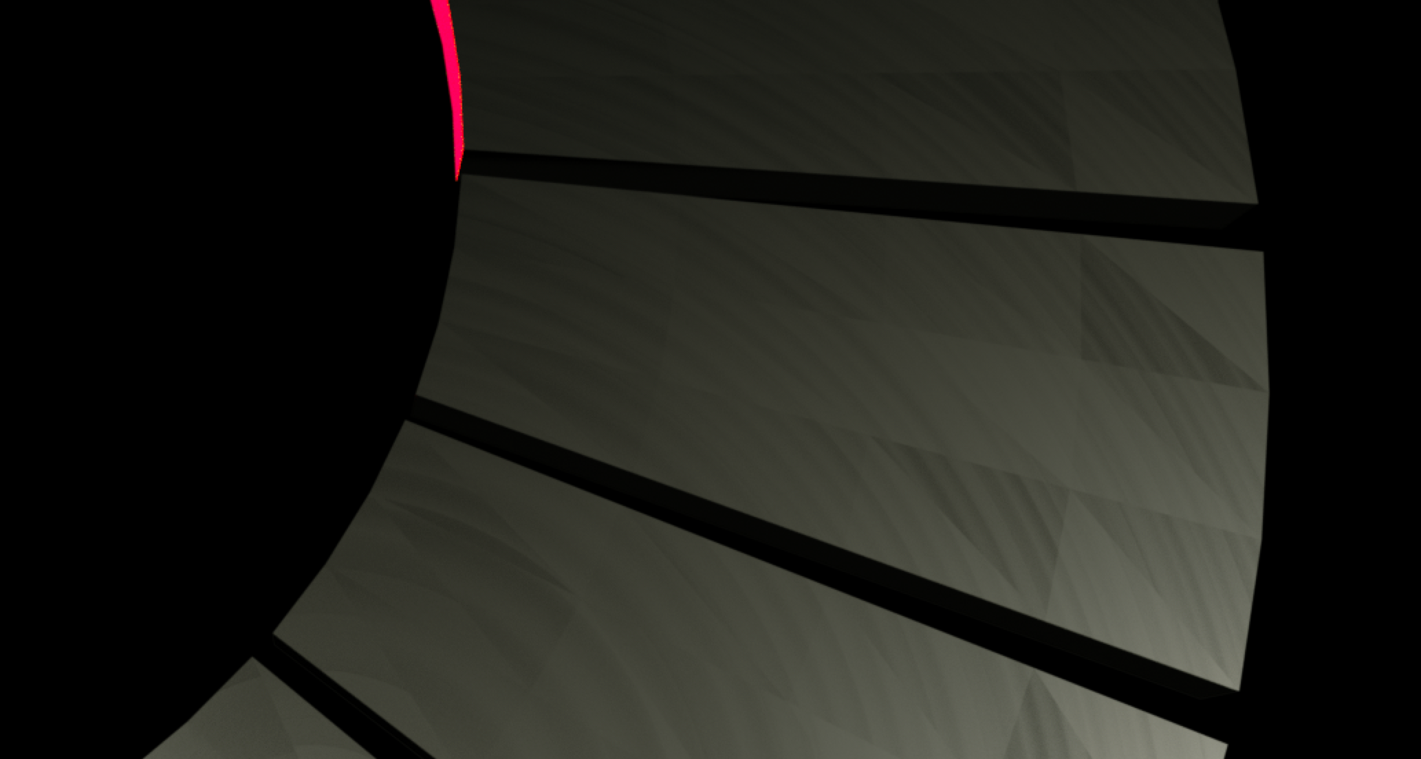

I'm working on an animation and getting weird texture artifacts on Octane shaders. I'm using a simple diffuse material. If I switch render mode to directlightning or PMC the artifacts are not there.
Any idea what this could be. Using the latest version of the plugin (2.23.1 rc13). Attached is the (isolated) object. The mesh is clean.

make a search for rayepsilon,
best

Thanks, upping that value solves it indeed.
