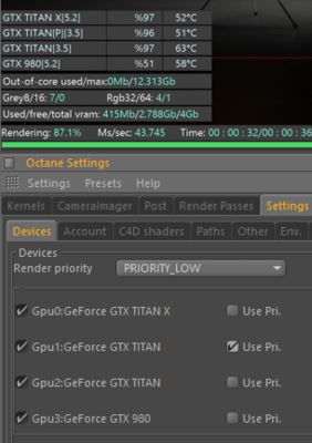

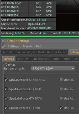

I noticed this a little while back but was too busy to investigate. I just did and it appears the Octane plugin is mixing up my GPUs. I checked it against MSI Afterburner and it looks like the readings on the HUD are the ones that are mixed up, while the Devices tap is referencing/manipulating the correct cards. This is on my Windows machine (see signature).

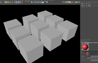

hey aoktar. im having trouble now..
see this image? its a grid-cloner of cubes and an other cloner, that clones small sheres onto the vertices of the cube-grid-cloner.
c4d renders fine, as expected. see here.
in octane live-viewer the small sheres just dont show up!
yet in the render to picture viewer they do...
any advice why they are missing in LiveViewer?
