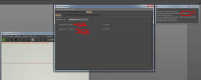

Hi. I have two videocards in my comp (780Ti 3Gb and GTX 980 4Gb). But Cinema 4D recognizes all 4Gb only then 780Ti card is off and excluded from render process . When I turn on both cards in GPU Info toolbar I see only 3 Gb videomemory. Why?
Thanks.
Regards.

It's not a matter that how much ram is recognised. Octane can use the vram as minimum amount of. It hold same data in each gpus to work parallel.

So if I want render with both videocards I can use only 3Gb vram?

yes, that's a simple logic.

You forget that first card will loose some extra vram due OS's and C4D's needs. Practically it's impossible to have free 4Gb on first gpu .

Aoktar, no of course I did not forget about it. I know that Otane dose not add vram of installed cards. But why I can`t use GTX 980 memory for Octane render and 780 Ti for OS`s and C4D? And use power of cores both cards for render? Why I need turn off one of videocards for using maximum memory?
Sorry, if my questions seem silly to you :)

This should be clear to explain. It has to copy same data to each gpus. How can you copy 4gb data to a gpu which has 3Gb?

Ok, I understood. Thanks a lot for the clarifications.
