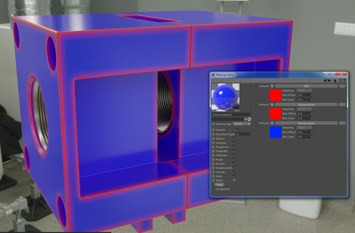

Breaking up Dirt Shader, how?
Hey guys, I'm trying to get worn edges and I know I'm on the right track with the dirt shader as a mask with invert normals checked. However, I can't seem to figure out how to use a noise or texture to break it up a bit. Here's a simple illustration of what I mean. So I need the red areas to be more like worn or chipped, but obviously no where near so uniform.
hi rodross, you can also use a turbulence texture for this. here is an example in the standalone, the same would applicable in the plugin.
http://render.otoy.com/manuals/Standalo ... age_id=327

Hey rodross - You can also check out this tutorial.
https://vimeo.com/100085092

Hey,
I also made a tutorial on getting similar results but using textures instead of noise:
https://vimeo.com/114419480

Hi rodross,
theres is some nice threads about Dirt and Worn Edges shaderstuff.
http://render.otoy.com/forum/viewtopic.php?f=30&t=40848
http://render.otoy.com/forum/viewtopic. ... 20#p215041
http://render.otoy.com/forum/viewtopic. ... er#p215170
