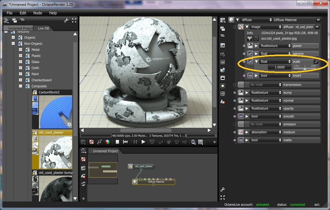

Hello Guys a new question,
I need to use the scale option for my textures. Is there a way to set the scale values already in the material template library. According to a Wikipedia article I have to set the line for scaling like "map_Kd -s 1 1 1 lenna.tga" where s stands for scale, but it doesn't work :/.
Is there another way to do it automatically?

hi David, do you mean the textures in the liveDB? also, just want to make sure which version you're using, is that v1.20?
There is a scale value that can be adjusted as shown here: the example above uses a texture by user Elvissuperstar, from the LiveDB.
