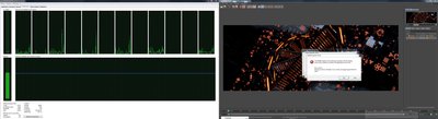

When i start the render (MAJ-R), octane load all this stuff and show me the render in the picture viewer (so far so good), but, sometimes he crashed after 1min30 (during the loading), sometimes he crashed during the render, sometimes at the end (during the save) and sometimes he render 3days long without any problem..
The crashs are différent, sometimes a c4d bugfil, sometimes a nvidia error (see attachement), sometimes black screen, sometimes my dual screen exploade (i'm on 1 screen on a fuc***g small résolution something like 800*600 :? ).

this is not related with octane. just a opengl error.
