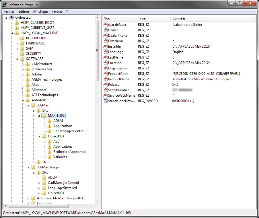

bicket wrote:Installdir of my max 2012 is located at HKEY_LOCAL_MACHINE\SOFTWARE\Autodesk\3dsMax\14.0\MAX-1:409
Installdir of max design 2014 is just HKEY_LOCAL_MACHINE\SOFTWARE\Autodesk\3dsMaxDesign\16.0
Thank you!
Could you please just post the screenshot of thie regedit window with these keys?..
Thank you!
Here it is
PortFolio
4 x TITAN - Win 7 64 - Octane Rocks

bicket wrote:Here it is
Thank you! It was extremely useful.
I'll improve the installer in next version - it will know about 2012 now.)
PS. What a crazy mind have thought out such a crazy registry paths, moreover - having completely different structure for different versions of the same product! :lol:
