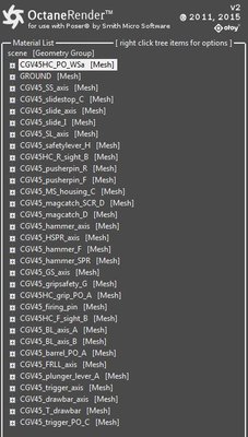

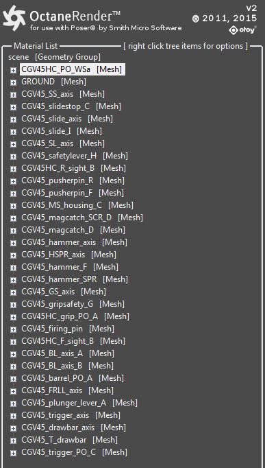

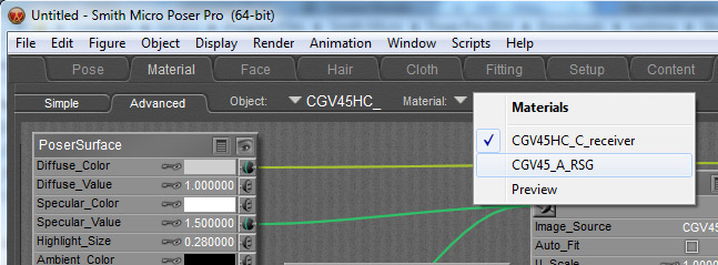

I only see the prop in Poser, and two items in the material room, and it has a number of morphs. But when I open Octane Render, there are a ton of materials I can edit. Which is great, I can get it how I like it. But it's not grouped in Octane, which makes me edit each part every time I use one of those props in a new render, which takes a long time. If it were grouped all off the 1911 body, I could edit it once and save to a POC file.
Can I do that to greatly improve my workflow?
Octane has a lot more materials than Poser - group how?

That is because the model maker of that gun prop has setup the gun as many individual props all parented to a single figure, each with it's own material. Just like if you parent a cube to another cube - they are still separate props, and they would be listed in the plugin separately. The plugin has to do this for case where for example you parent a genital prop to a figure, and they both have a material "skin", but the texturemaps in the figure and the prop "skin" materials are different. Having the gun as multiple props is a poor way of doing it - IMO it would be far better off to have the gun as a single prop with multiple materials. To resolve this, you need to export the gun figure as an OBJ and re-import it back into the scene - then it will be a single prop with multiple materials.But when I open Octane Render, there are a ton of materials I can edit. Which is great, I can get it how I like it. But it's not grouped in Octane, which makes me edit each part every time I use one of those props in a new render, which takes a long time. If it were grouped all off the 1911 body, I could edit it once and save to a POC file.

Weird, I tried it quick and it worked on two and not another. The one that it didn't work only had 5 or 6 materials though, so not as big a deal. Lost the morphs, but I expected that. It will be much easier to create props in their default position. Then I can use the regular, morph as I like (hammer back, trigger back, slide back, etc) then do a quick OBJ export-import. Faster then playing around with 12-20+ materials every time.
