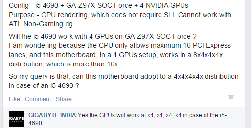

I heard back from Gigabyte about the 4 GPU compatibility on the GA-Z97X-SOC Force motherboard, with an i5 4690 CPU.
And they are claiming that 4 GPUs will work fine, and will be recognised by the board without any problems.
The four GPUs will run at x4 x4 x4 x4 distribution.
The x8 x4 x4 x4 distribution mentioned on there website is only for SLI configuration, where in the fourth GPU wont work.
I guess in terms of compatibility I have got the answer, that all 4 GPUs will surely work on this motherboard.
Now the other question is about geometry & texture data transfer speeds into the GPU. (Render times will not be affected by x4, as Glimpse mentioned)
So if I do a quick calculation, considering all 4 PCI slots work at x2.0 or v3.0, then,
x1 on PCIe v2.0 = 500 MB/s
x4 on PCIe v2.0 = 2000 MB/s
x1 on PCIe v3.0 = 985 MB/s
x4 on PCIe v3.0 = 3940 MB/s (GTX 970 and 980 will get loaded within seconds, Titan X will take 4 - 5 seconds)
Geometry loading time for each frame:
4 x TitanX on CPUs 16 (Z97) lane restriction = 4 to 5 sec
4 x TitanX on CPUs with 28 to 40 (X99) lane restriction = 0 to 1 sec
Would be great if you guys could comment on these calculations.
I really wish I could get the X99 setup. But I am feeling comfortable with this setup, specially
when it is scalable with up to 4 GPUs. And I am pretty certain that I wont be hitting a 12GB VRAM mark with
product animations any time soon (fingers crossed)
