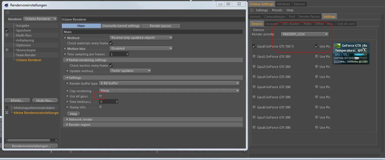

Hi KeeWe,
GPU priority should work.... are you sure, you checked the "Use Pri." mark?
See the screenshot below.
Maybe it also has to do with "Use all GPUs" in the render Settings tab. I leave this off.
As you can see, my first GPU (with 2 Monitors attached) is only used by 75%. This is enough for smooth working on other task, even Photoshop, After Effects and so on. I have the same behavior on GPU usage, no matter if I do preview rendering or final rendering with the picture manager.

If you have your GPU set to low priority and Primary is checked, that is as good as it gets on a 1 GPU system. You need more than 1 GPU to be able to work almost normally while Octane (plugin or standalone) renders. At least that has been my experience.

Thx for your detailed answer. The Problem is: i only have one GPU installed. The graphics unit of the CPU would be probably enough to do simple tasks but as far as i get it i need to plug one of my monitors in the connecter of the Mainboard. A software side solution is not possible... right?
@jblessing
Thanks for the clarification on that one. I thought it could be just my system or some settings but if its normal, i'm fine with it. Although some settings to manipulated the usage would be pretty nice. :)
