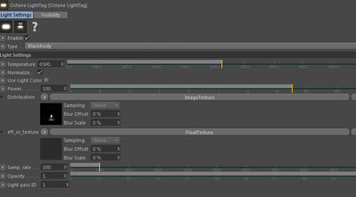

Really strange working with IES lights, see screenshot.
All samples are on 1.
IES Lights - Bug ?

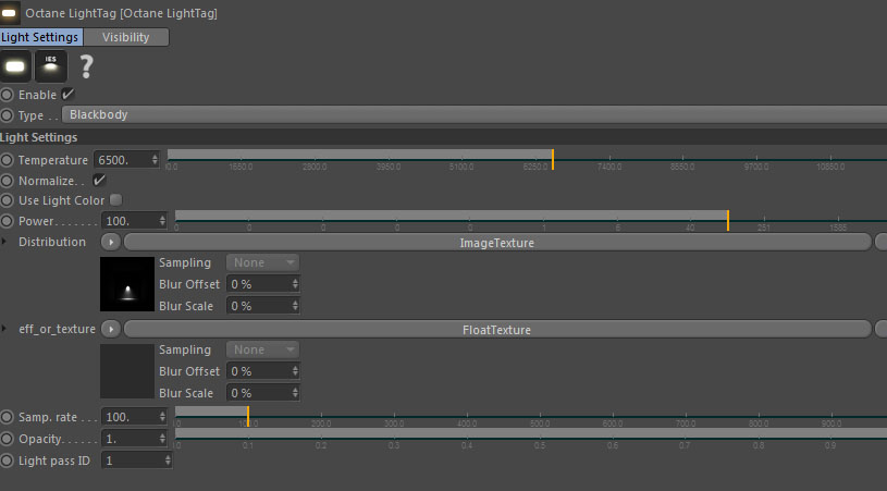

if i'm not wrong! in here C4D we can not use ies file in material but lights. Maybe same with 3Ds Max?
This is how i use ies..

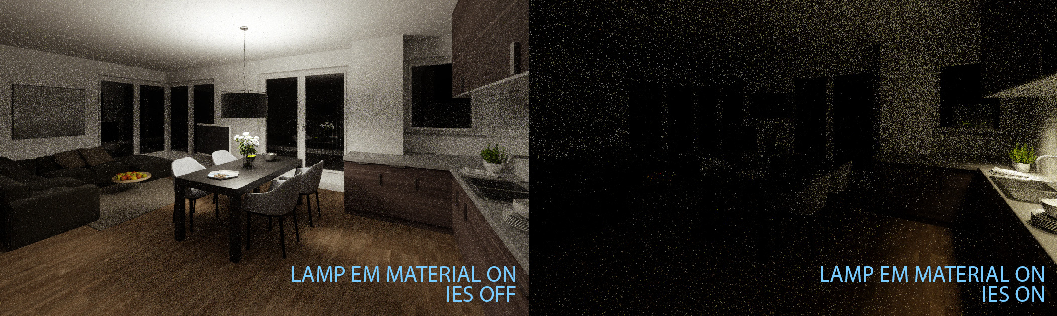

Thanks for the quick feedback.
Oli, I only need IES lights on the underside of the kitchen cabinets. The lamp over the table has a light material.
The strange thing is that as soon I switch the IES lights on every other light in the scene gets super dark.

Ah, ok. Yeah that's weird.RobSteady wrote:Thanks for the quick feedback.
Oli, I only need IES lights on the underside of the kitchen cabinets. The lamp over the table has only a light material.
You sure you just don't need to let it converge with more samples? Just thinking out loud here. We usually need to let it go above 1024 samples to see what the light is doing...
Throwing it out there.

check samples on both emitters, set to 1 then increase it when necessary
use ies emitters and not textures, set them to movable proxy.
