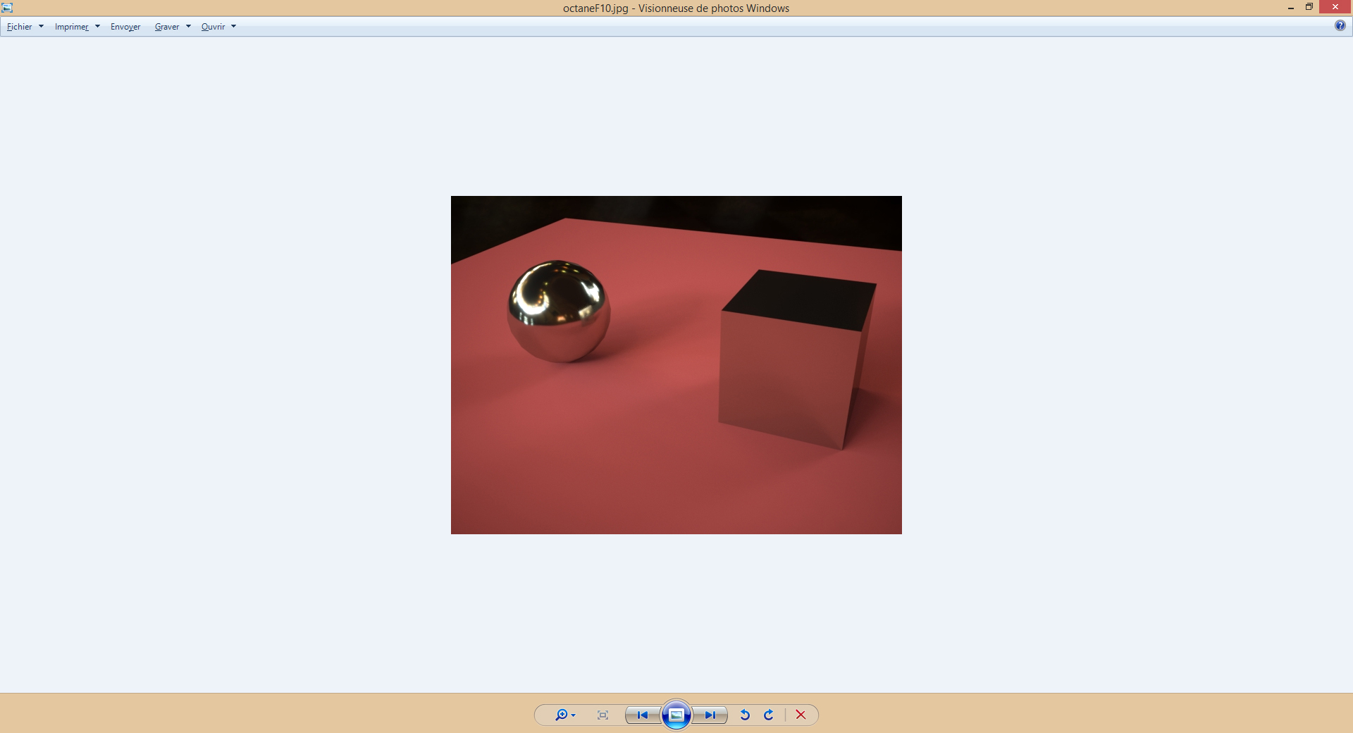

Ok, I think you are right. The 3 images are the same. But this is a crazy think.
I have tryed with a color picker and they are the same. I have tried to do an anim of the 3 images and they are the same.
BUT. If I visualise it in windows previewer, the F9 images is always different.
I post some scene capture to illustrate this.
Why? and why always the F9 rendering?

Can you please send to me one of this scenes?

In the original post the F9 is more saturated. Can't understand why no one else can see it.

Some time ago I found a similar problem. F10 looked different from F9 if it was saved by the LW native file system. Then Juanjo suggested I use the Octane file saver instead, which is the Render Passes node. You don't have to use the passes at all, just the Main output. After that F9 & F10 always looked the same.
