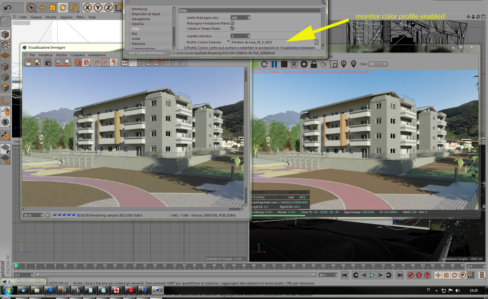

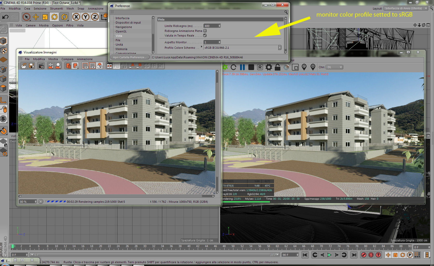

I think to have found the reason of thet differences:
If I set (correctly) my color monitor profile in Cinema4d preferences the LV and PV results are different.
If I set SRGB as color profile are the same (see attachments).
But Then I have troubles saving the images (with SRGB profile, another Cinema 4d setting) and opening the image in Photoshop that result more desaturated than PV.
I have to make some test again pherhaps saving the images without the SRGB profile...

I'll post here my personal solution, that works.
1) in Cinema4d preference I set Srgb profile, so I have the same results in LV than in PV
2) when I save the final image I set "no profile" (in rendering parameters)
3) when I open the image in Photoshop (check that in color management you have setted "ask before open" as option for the images without profile):
- check on "assign a profile" (here you have to insert your MONITOR PROFILE)
- check on "after convert in the Work space (here I set SRGB)"
In that way all the images in LV, PV and PS have the same color.
Any comments or suggestions are appreciated since the argument is not really aesy to manage.

There is only two factor to differ the colors in Picture Viewer, render buffer type and image color profile of saved images.
- LV is always 8bit and affected by camera imager settings.
- Picture viewer, is affected by camera imagers if the render buffer is "8bit" or "floatbuffer tonemapped". "Floatbuffer" is linear and does not affected by camera imagers. It's got gamma 1.0. You should use linear color saving profile to avoid user confusions.
