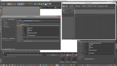

Animate Render Settings Parameters
With "Overwrite kernel settings" in render settings of Octane renderer, you may animate parameters (with red dots).
