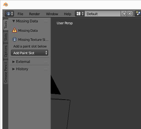

Well, this is driving me bunkers.
Here's what I do: Could anybody please tell me what I'm missing?
1) I open a new project, delete cube, add sphere
2) Add Octane material to sphere
3) Smart UV-unwrap sphere (or unwrap it in any other way)
4) Create a new image titled Sphere1 in the UV-editor
5) Still in the UV-editor, click Image and "Pack as PNG" (instead, I've also tried Save As Image and then packing the .png in the .blend, but that doesn't make any difference)
6) In the Node editor, add Octane Image Tex, open Sphere1 and connect its output to the Material's in.
7) When I now go into Texture Paint, I get the message "Missing data" and the button Add Paint Slot.
Please see attached .blend.
Which step did I miss above?
(If I do go ahead and Add Paint Slot, then I can paint on that, but it doesn't render since the image Sphere1 is open in the Image Tex node...)

One of the main problems is that you can't paint on an imported image.
Try this:
1) Open a new project, delete the cube, add a sphere
2) Add Octane material to the sphere
3) Smart UV-unwrap the sphere (or unwrap it in any other way)
4) Open an existing image from a hard drive in the UV-editor
5) Still in the UV-editor, click Image and "Pack Image" and Save All Images in order to embed the image in the .blend file.
6) In the Node editor, add Octane Image Tex, open your image and connect its output to the Material's in.
7) You can now render the image.
8) But when you go into Texture Paint, you get the message "Missing data" and the button Add Paint Slot again...
