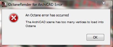

I got an error while opening the OR viewport uwing the plugin in Archicad.
The scene has too many vertices ( if I remember correctly or 3dpolygons or something )
Anyway It is too large.
I got 3b on my GPU, but I guess I got to the max :oops:
I made a maquette-look scene with also a forest of hundreds of simple trees (round colum and sphere).
When I leave out the most trees I can load the scene without any problems.
The next try I will see if I can rduce the resolution of the spheres to see if that helpes.

The problem does not seem to be the video memory, but just the number of vertices???
Error: "A critcal error occured
The Archicad scene has too many vertices to load in Octane"
Is there a limit to that?
I assume vertices is the same as polygons?
In the scene that loads OK now has almost 589.984 polygons
The scene that did not load has a little over 780.000 polygons
Anyway, I lowered the resolution of the spheres I used to make the simple trees and I can load the scene without problems,
so no sweat needed to finish the project :mrgreen:

Jeroen - I am so sorry I missed this thread! Best to email me next time if urgent :-)
In order to address the slow load time with 1.11, I put a hard cap on vertices and polygons (I think it was 3million). Clearly that number is not high enough! Maybe 10million would be a better limit?

I do not understand why you have to set a limit for the vertices? Maybe you need to do that for techincal reasons?
Originally the plugin did an initial analysis of the scene to work out the exact number of tri and vertices to then allocate enough space to transfer the scene to Octane. However this analysis pass was taking almost as much time as the actual transfer, so it is much quicker to simply allocate a "large" number of tri's and vertices and use what's needed.
I just uploaded a new version - which has the limit increased from 3Mil to 10Mil. The amount of RAM this uses up is very very small (so I could make it 50M!). At some point I will make this number configurable in the Configuration.

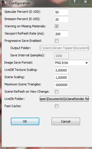

Hi Paul,
I had this error:
Then I changed 10Million to 50M for triangles:
And now It loaded correctly.Super this being possible to adjust in config.

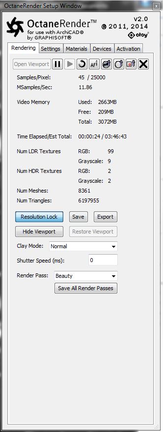

Now, after I having been able to load the scene correctly, I noticed that the trianlge number is 6.1M.
So why was it not able to load with config set 10M (or was it standard 1M)?
(btw: you see I need to transfer to my other machine with 6Gb and work with out of core render..I almost used full 3gb vram)
Loading the scene takes quit a while (about 35 seconds for caching materials and 2:30 minutes for loading scene).
How can I speed this up? Enabling fast cache?
The "Maximum Scene Triangles" parameter is perhaps a little misleading - it is the maximum used for triangle AND vertices. So it will vary for each scene, but a scene might have 3 unique vertices for each triangle - 3.3million triangles will use up the 10 million vertices. But if vertices are shared between triangles, the number of vertices is usually very close to the number of triangles. I will change the parameter name to Maximum Scene Vertices/Triangles. Keep in mind the current maximum number of TRIANGLES Octane can hold is approx 2GB, which is about 10Million triangles (an exact max triangles number has been given on these forums by Otoy).
Fast caching is to speed up the material caching process only (which is taking 35 secs on your scene). In general, 95% if the caching process will be the plugin going through each polygon in the GDL objects searching for different materials. The tooltip reads:
When checked, you CANNOT render via the Octane Photorenderer UNLESS the Octane Viewport is already open, however starting the plugin and loading the OctaneRender Viewport is quicker. If you add anything to the ArchiCAD scene when the Setup window is open, you should close and reopen the plugin. Pen materials are not processed when Fast Cache is enabled. Restart the plugin after changing this setting.
