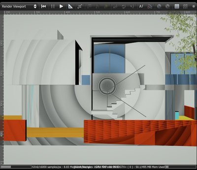

I am very new to Octane, I am currently using sketch up export OBJ file try to render it in Octane.
something strange appeared.
My render view have a large circal around it, is there something worng with my camera sitting?
Also I am using Demo V1.02 Beta 2.2 9800gtx+
apologize for my broken English.
Kind regards
A college kid from China.

I think that your model is not in scale meter...try to export in meter into your app.

Daniel79 wrote:I think that your model is not in scale meter...try to export in meter into your app.
problem solved
Thanks man!
