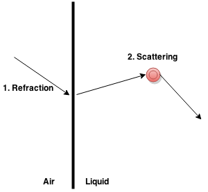

In Octane, SSS is only captured on the second bounce. That means the ray needs to pierce the medium on the first bounce and scatter on the second. This happens in the liquid only case (i.e. pierce the liquid on the first bounce and scatter on the second bounce). It doesn't happen in the bottle liquid because (depending on how it's modelled), you can minimally scatter on the 3d bounce.
SSS render pass in Octane only captures on the 2nd bounce.
I don't think the behaviour was any different (maybe there was a bug in some development build).
I don't think there's anything special about V-ray or Mental ray's behaviour. If your scene is almost exclusively glossy and specular reflections well then the reflection pass (direct + indirect) is exactly the beauty pass. Octane does the same thing.
I hope this clears it up a bit.
