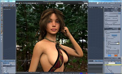

Here is a screen grab of the setup used with the image for reference - the only "light" in the scene is an HDRI. Note that there is no atmosphere, you don't need it to use HDRI lighting in Carrara. I use the Gamma value for the HDRI to adjust doth the color sharpness/intensity and the light/sun intensity. Not all HDRI are created equal, so there aren't really any "one size fits all" settings, but the closer you get to 2.2 (or more), the more intense/focused the sun light will become, and the more defined the shadows will be. Lower values will give softer lighting and shadows.
Hope this helps!

Actally, that's the Octane Environment level/intensity (which in this case is just the HDRI). If you look closely you'll see that the Carrara atmosphere is set to "none". Carrara sky's or realistic sky's must be enabled to have a sun in the scene (or maybe you can add it through the browser?). The Sun controls for the Octane environment are alway's there - with or without a sun.
One simple trick that can really help to get your HDRI set up and oriented properly is to add a sphere to your scene and give it a chrome or polished aluminum shader (something reflective). It will help to determine exactly where the sun is in your HDRI so you can rotate it to give the proper illumination direction for your scene.
