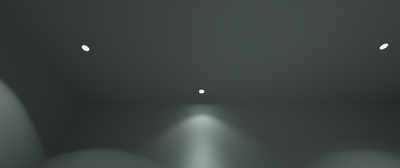

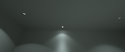

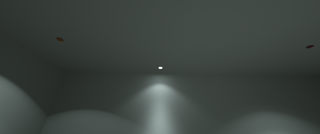

Sometimes the sources of light aren't visible below a certain angle of view and I don't know why... :roll:
sources are 100% visible
sources are half visible
sources are almost invisible (right and left)
