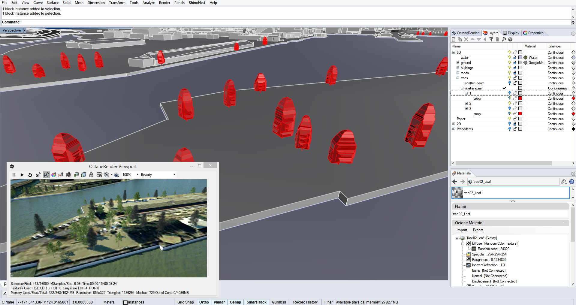

An unrelated (yet still proxy related) item - see attached screenshot.
  • Proxies (.obj referenced, but no .csv matrix) that are hidden, or on a hidden layer, still show up. I realise that the 'hide' option works, but it's a bit counter intuitive in the Rhino workflow. It's also not possible to select multiple at once to check the 'hide' box.
  • Random colour textures do not apply across instances (however it does work when a .csv is applied).
Thankyou for the quick response as usual Paul.
