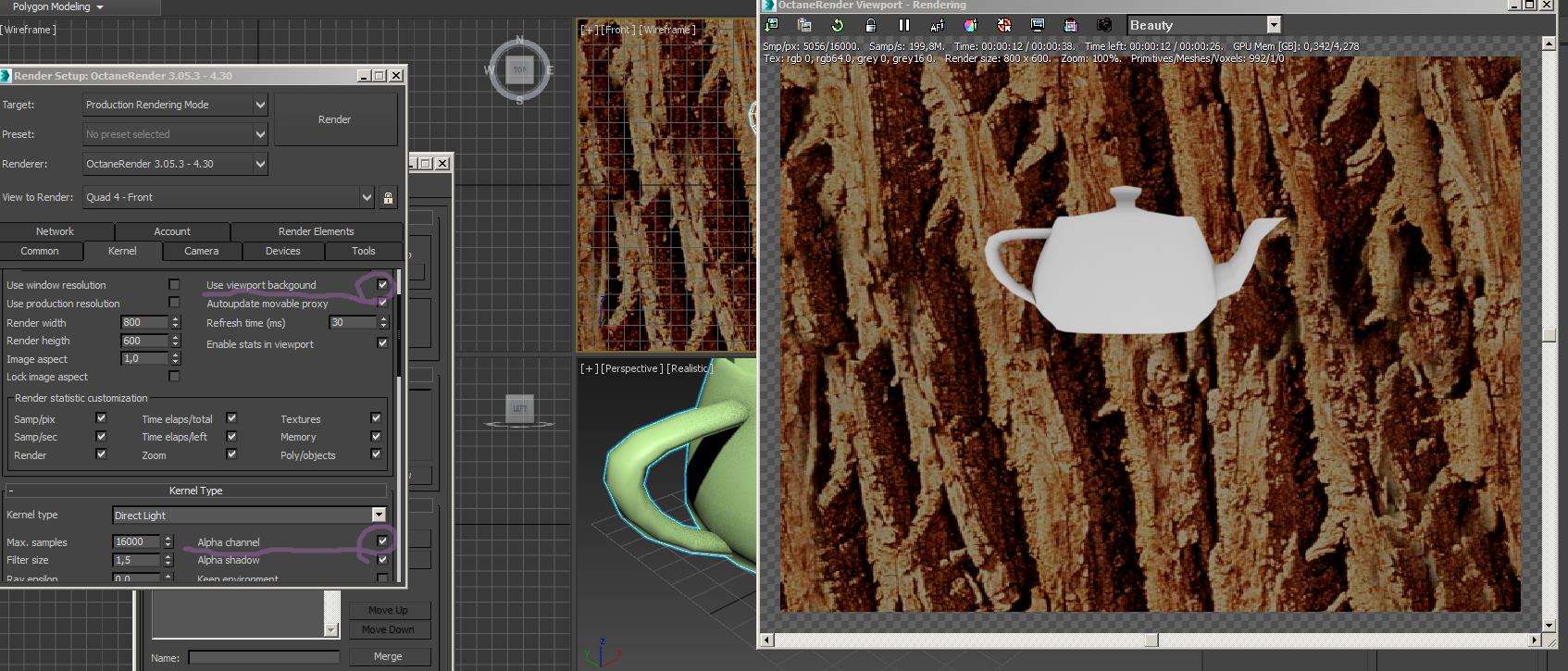

I tried to do a picture today with Hdri envmap as environment lighting method. Than i checked alpha and use background .
So when i render within octane inside max no prob i do have the perfect picture with my grey background [ kernel is showing it].
But !!!!!!
When i save that picture the grey background is missing and instead it's black [as if no background were set] ...
Wait a minute ??? Do octane is lying to me ??? Why is it not saved as i see it ???
But !!!!!!
