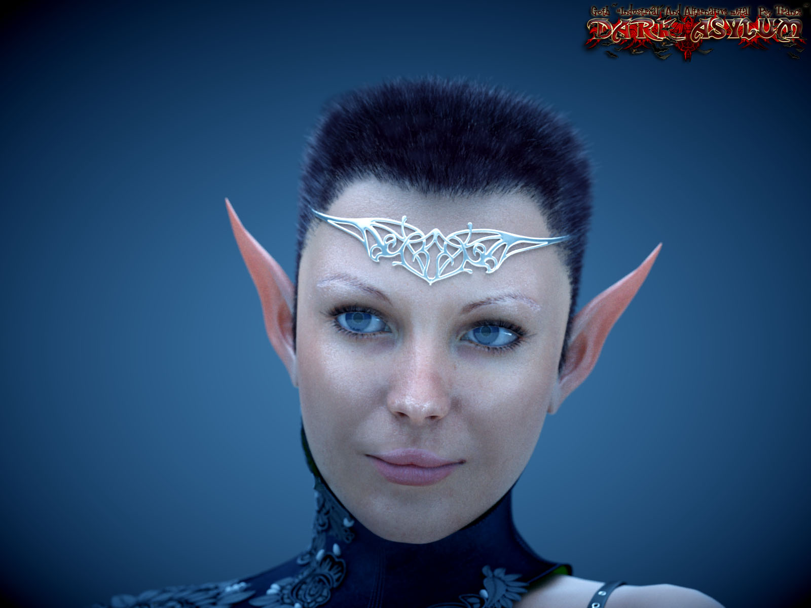

Here's some examples of what I've achieved with realistic hair and shaders that I built myself skin shaders and hair shaders . (Incidentally, these will be available for download as soon as I finished them)
