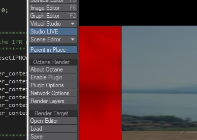

marchermitte wrote:I sent you the link in a PM.
Again, thank you very much!
Thanks, after see your scene I just remember what is the problem: you have the "Studio LIVE" enabled. In this mode the Layout is sending continuous refresh commands, and the IPR becomes crazy ;)
Disable this option, it is not compatible with Octane.
-Juanjo
