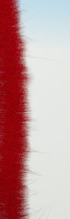

To clarify the difference between live preview and actual renders, here are a sample of each:
The one above is the 'real' render - the slightly blurry one below is the Preview, both @ 100 samples.
It may be a bit hard to imagine from these samples, but the full version of the Preview does look fluffy and hairy, while the render looks more like a haystack.
Which is why I'd prefer to go with the previews...
EDIT: It would, of course, be possible to make the real render more fluffy by decreasing hair sizes. But the project is about one GB already, and again; the previews are fast and they do have the right look, so it would be great if it were possible to save them. Or find a way to emulate their character (and render time) in the real renders.
