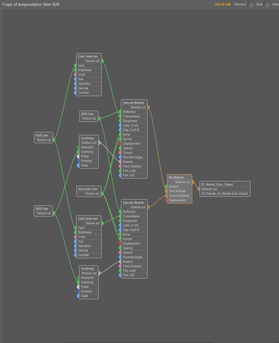

Here's an example I put together of tonysculptor Skin R20 being used on a head model. The two different pictures of the nodes are to illustrate where the texture map is added. It is just replacing the one RGB color that is feeding into the color corrections which are feeding into the transmission pins. I also upped the scale on both scattering nodes to 3000. And I adjusted the final mix material node to .25. And one last change I made was lowering the specularity from its rather high default to an RGB value of 154-154-154. I mentioned in an earlier post that you might need to adjust the gamma of your image, but I left it at 2.2 here and I think that's working fine.
I have pictures here of the tonysculptor skin R20 with the values set as described above, but with its default color instead of my skin texture. And then with the skin texture added in. This was just to demonstrate how to get good results quickly without changing too much around in Tonysculptor Skin R20. From this point, I'd want to start tweaking for improvements, making adjustments to bring out the darkness in the eyebrows, making a custom spec and roughness map, adding a bump map etc.
Also note, I'm using the DAZ Octane plugin version 2.1
