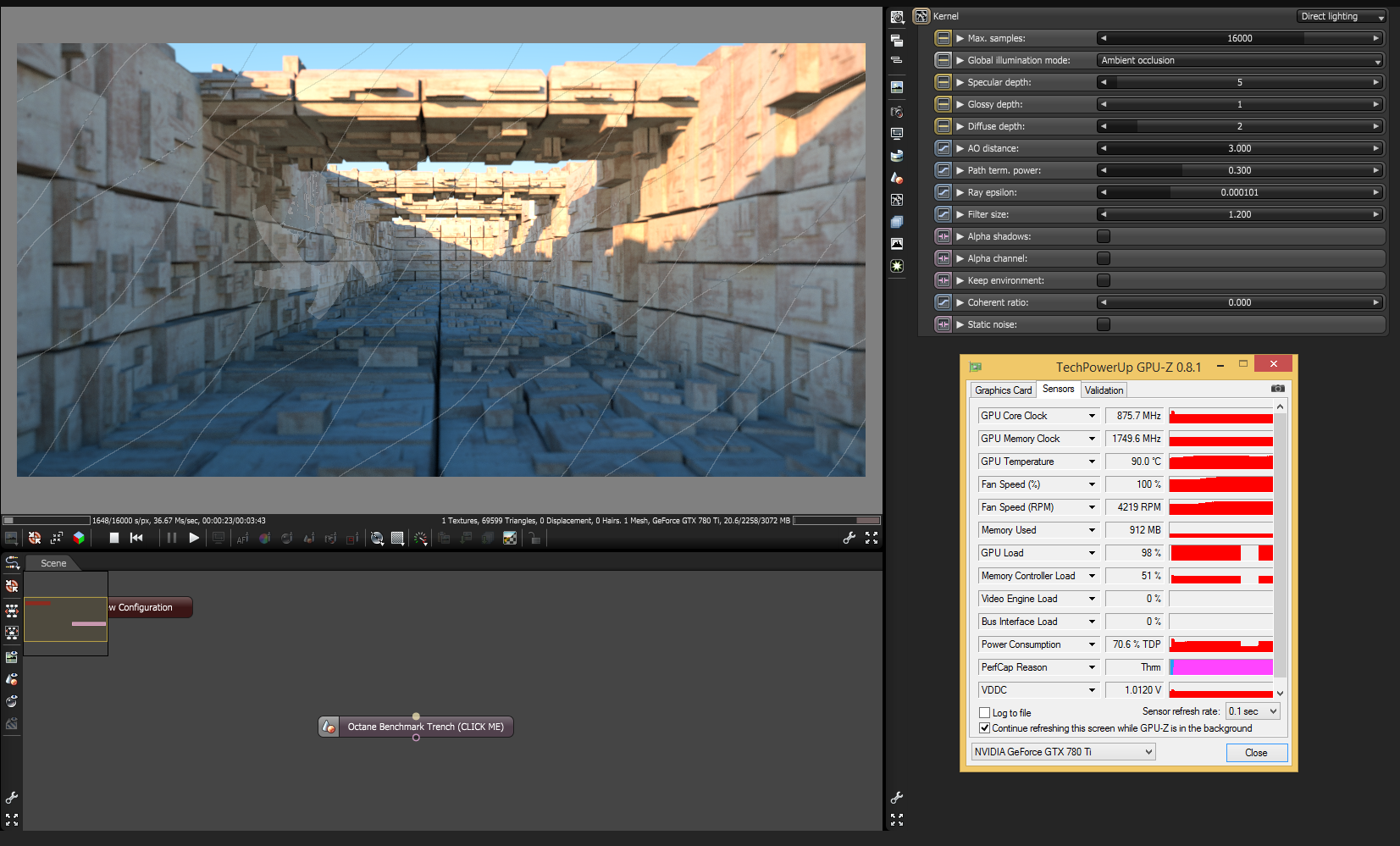

After checking the benchmark topic here is my results with the single 780ti on the standalone. By looking at the temps on the thread, mine looks way off O_O

Zee wrote:After checking the benchmark topic here is my results with the single 780ti on the standalone. By looking at the temps on the thread, mine looks way off O_O
simply make sure Your cards has enough room to breath
& it's enough fresh (cool air) coming into Your case..
- if You don't make those two..You'll loose performance &
increase possibility of hardware failures =)
Posts: 16068
Location: Türkiye
It depends to kernels, settings, scene content. I can see 100-200 ms/sec with DL on 2x780, for C4D. Demo scene is consist from a single mesh. But plugin can divide the scene to meshes for interactivity. This causes some performance loose but gives interactivity for objects. So you can immediately move or change your geometry and see in rendering.
