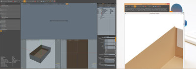

Hi Paul,
I have to proposal requests.
1. Can you make the Modo roughness amount to be read by octane plugin.
2. Can you make octane plugin default to look like the image attached. If not, can you please tell me how to tell the toolbar windows above the render window how to keep the dimension I have costum changed, it does resize to a default that is small and hides the info I need there.

Every user has a different need as far as layout is concerned, so a change for one user might not be suitable for everyone else. However, if you have an understanding of Modo Configs, you can override the default behavior of the Viewport Toolbar. http://render.otoy.com/manuals/Modo/?page_id=1091 explains how to do this for your username/password, however the same principal would apply for taking the Viewport frame specification from your Modo801.cfg file and storing in the default file.2. Can you make octane plugin default to look like the image attached. If not, can you please tell me how to tell the toolbar windows above the render window how to keep the dimension I have costum changed, it does resize to a default that is small and hides the info I need there.

Hi Paul,
Thank you for the fast reply and help,
Can I ask you to assist me with the toolbar is I will not be able to change the toolbar window size. I will work on this today.

Hi Vlad - at the moment when you rightclick the Viewport, the toolbar pops up withCan I ask you to assist me with the toolbar is I will not be able to change the toolbar window size. I will work on this today.
Code: Select all
layout.createOrClose octaneViewportControlsCookie title:{Octane Viewport Controls} width:608 height:48 style:standard layout:edit.octaneViewportToolbarLayout
Code: Select all
layout.createOrClose cookie:schematicMaterialMacrosFrameCookie title:{OctaneRender Setup} width:800 height:600 style:standard layout:schematicMaterialMacrosFrame persistent:true
You will probably need some Modo UI customization skills to do this.

face_off wrote:Hi Vlad - at the moment when you rightclick the Viewport, the toolbar pops up withCan I ask you to assist me with the toolbar is I will not be able to change the toolbar window size. I will work on this today.So you cannot really change the auto-popup. But you could create your own popup, which you could open with a custom button you add to a Modo button bar. The popup could be based on the OctaneRender Setup frame, which is opened with:Code: Select all
So I /think/ if you copy the schematicMaterialMacrosFrame into a custom Kit, and remove the Schematic and left panels you will get what you want.Code: Select all
In the next month I can push through some mods to the plugin to make it easier for you to customize the panels.

Hi Paul,
The images I posted on the forum was what i have not and what i use with modo. What I can not adjust is the popup windows that follow the render windows, I can not adjust it's size, to have the render parameters bellow the toolbar. I will tray your input right now and let you know if it worked
