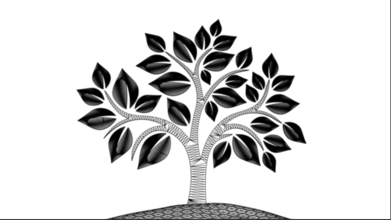

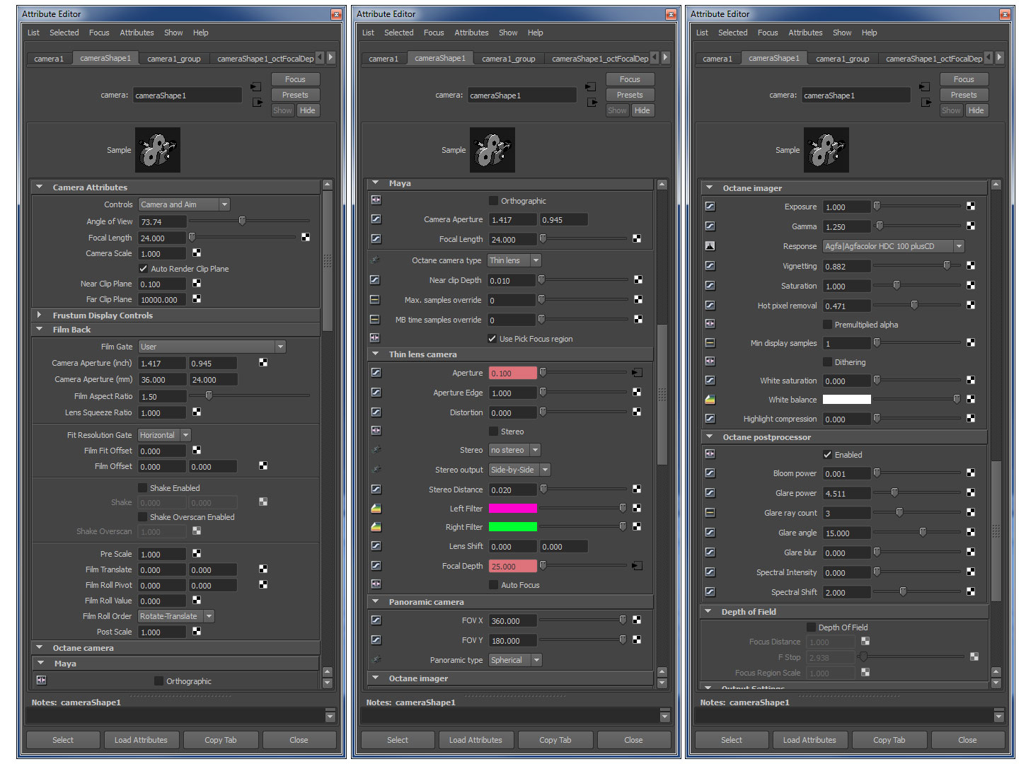

I am working on a scene but can't get sharp focus.
I have tried changing Aperture to the lowest number, etc.
The tree and everything looks a little soft.
Thank you for any ideas, tips I could try!

why dont you set it 0 ?

Sorry, I meant that I have tried every setting I can imagine.
0, 0.001,0.010, 0.100, etc

Disable the post processing and check the kernel for the "filter size" setting. Make sure it's the default of 1.20 or less.

Thank you FooZe, I think that was it.
The filter size was at 3
