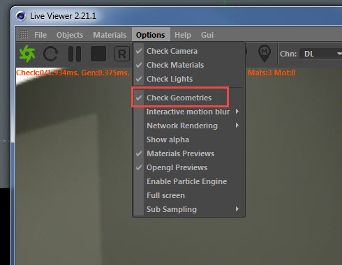

The same is happening to me but on a licensed version. How can I fix this?
First, you should activate "Check geometry" option.
Second, put a octane object tag to moving objects. This specify which objects will be updated.
You can ask that: Why we are doing this complex way, else automatically update every objects? Because we seperate the structures to able immediately update some part of objects. Seconds, geometry update is slow in Octane. We are trying to be away from updating all objects on every times.

I don't have any moving/distorting geometry in my scene. However, I still checked the "check geometry", and I've added an octane object tag. Here I attach my scene which does not update when I open the live view, load the scene and press play.
