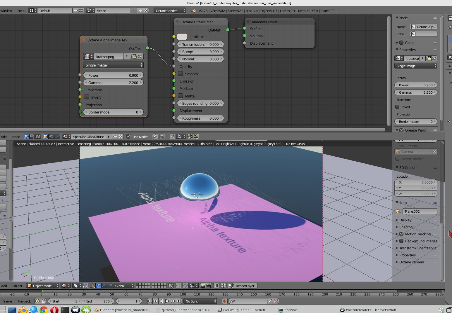

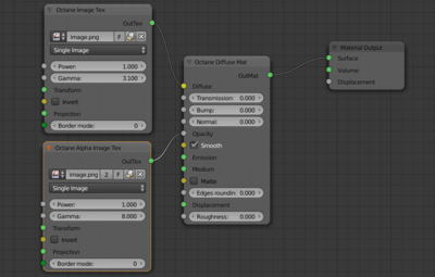

I asked Octane's support and they solved the problem!
It's not automagical like Blender's Import Images As Planes which provides an instant Transparency function, but it definitely works.
Here's the correct node setup, in case anyone is interested (important: THe Gamma settings should be adjusted; particularly on the Octane Alpha Image Tex):
Latest OctaneRender for Blender. Windows 10, i7 quad 3.7GHz, 16GB, 2xTitan.
mib2berlin
Posts: 1194
Joined: Wed Jan 27, 2010 7:18 pm
Location: Germany
Hey man was even to prepare a testfile for you. :mrgreen:
Cheers, mib
Opensuse Leap 42.3/64 i5-3570K 16 GB
GTX 760 4 GB Driver: 430.31
Octane 3.08 Blender Octane
justavisitor
Posts: 242
Joined: Sat Oct 05, 2013 5:34 pm
mib2berlin wrote:Hey man was even to prepare a testfile for you. :mrgreen:
Cheers, mib
Thank you so much! Don't worry, I always enjoy a nice alpha image. :)
The thing I didn't get is that it is necessary to have an ordinary image tex and an alpha image tex in order to render a realistic image, as opposed to a mask.
