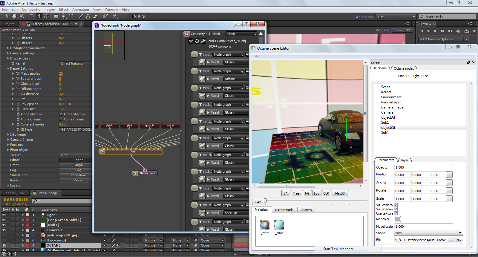

Render speed is same as standalone. Don't expect it quick as element3d. We are not in same category, it uses opengl rendering. And geometry feeding is fast as hell naturally.
In our plugin, added obj, ocs, orbx import. So it's possible to get premade scenes or objects from standalone or c4d via orbx format. Also it supports different content and kernels on different layers. So it's possible to render same scene with DL+info kernel. It support that usage of any layer or composition as a texture in objects. Additionally have a editor window to quickly edit the same parameters and object in different scene format.

Posts: 16068
Location: Türkiye
pegot wrote:Yes I do realize an Octane plugin wouldn't match the speed of E3d's regular OpenGL rendering mode. But I was thinking it might be quicker than the raytracing modes of E3d and AE's use of Cinema 4D. Also E3d can only use one GPU. I don't know if that's a limitation of the plugin or of After Effects itself. Will the Octane plugin be able to utilize multiple GPU's?
It would be great if import options included direct Alembic support - or would the work flow be to import an Alembic file into Octane standalone and from there bring in the animation to the plugin as an OCS or ORBX file?
Anyway, good to hear this is being actively developed!
You can edit and use alembics via standalone. Also of course it supports multigpu and mesh animations. I'm working on export from C4D for animated scenes. Also see attached sshots.
